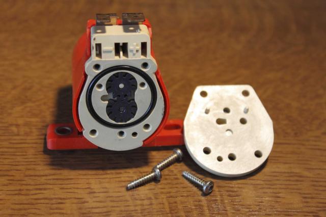

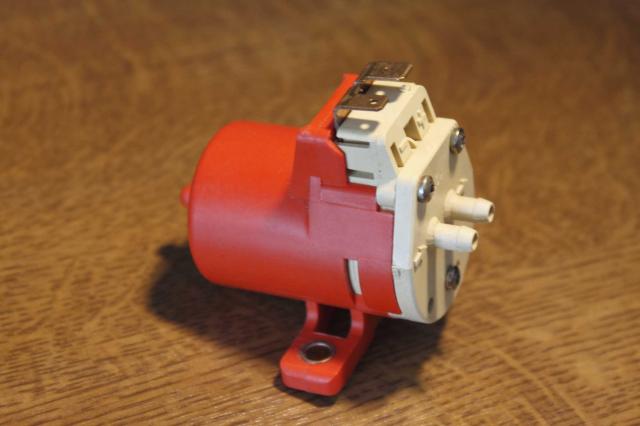

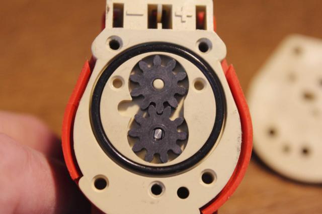

I think you dismiss windshield wiper pumps too quickly. It may be that the BMW pump is a centrifugal pump, but this type I use for filling and emptying liquids, is an all plastic, gear type and has a good performance. Pumping action is reversed by switching the electrical polarity.
Click to enlarge.
http://www.wiperblades4u.co.uk/universal-12v-washer-pump-ewp13.html#idTab
Testing this particular pump running dry, it was able to drawn up 400mm height of water in a vertical plastic tube.
Discharge pressure with liquids 43psi.
Pumping water out of an air reservoir it would probably provide quite a useful source of suction.

Emulator, 400 mm is almost nothing. You need 5 meters of vacuum to remove half the air.
You are looking down the wrong end of the tube.
300Kpa is 43 psi, more than enough to operate mechanically linked syringes and provide all the suction you need.

400 mm is not a useful vacuum for any kind of vacuum filling. Run wet, if it is capable of putting out 43 psi, then maybe it will pull a strong vacuum, but the plumbing also gets a little more complicated. You may also need to be careful not to do any damage.
The maximum suction you can get from an ideal pump is 1 bar or 100 kpa or 14.7 psi, which is able to lift a column of water 10 metres. A real pump often only produces half that suction. The output pressure can be very high, gear pumps are often used to power hydraulics, but suction is what is needed for refilling.
So I think the windshield washer pumps are no good as vacuum pumps, whether they are the centrifugal or the gear type. The diaphragm(?) pump linked to by Smile, produces much better suction, claimed to be 85 kpa which corresponds to 8.5 metres of water.

PeterBJ, depending on the construction, if the intake side is vacuum-tight, you may be able to get a good vacuum with a pump designed for liquids. The trick is to keep the pump filled with liquid. It's all in the plumbing.
Emulator, if you run your pump dry, you will probably burn up the rotors.

I know. At my work at a paint manufacturing plant I have used a lot of xylene and other solvents to prime pumps. A gear type pump that is worn has very little suction if it is not filled with liquid.
Gear pumps are only suitable for liquids, so wouldn't it be difficult to design a system to keep the pump filled with water and also allowing the pump to suck air. Wouldn't air stop the pumping?
