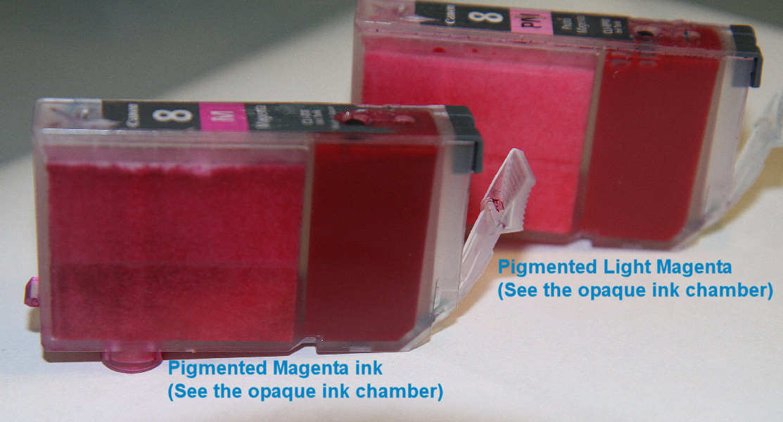

Finally I've got some colored inks for testing, see pictures below:
To show you that the cartridges have indeed pigment ink: have a closer look at the cartridges and not the difference in dye and pigmented ink. The pigmented ink looks milky (opaque) !
Now you can see the difference between light magenta and magenta: the left is printed with the light magenta, giving the picture a greenish cast and on the right the colors are on spot. This is amazing: true pigmented ink in Canon BCI-6/CLI-8 cartridges is possible and it so far -keep my fingers crossed- no clogging at all.
Only one problem with pgimented ink: the ink flow is lower than dye ink and therefore high speed printing is impossible. Look at the last picture where made a solid block of magenta in a Word document and use normal paper to print on.
I will update as soon as possible on this experiment, for the moment it looks very interesting and pigmented ink can be used in the dye based BCI-6/CLI-8 cartridges !!!

I'm using microporeus paper (Sihl X 280 gsm high gloss) which is 100 % compatible with both dye and pigment ink printers and does not smudge at all. So far it looks really great, and I can see even some gloss differentials on the print where the (light)magenta ink is sprayed on, which is a known problem with pigmented inks.

Hmm, why should I test the gentle rub test ? This microporous paper is drawing the ink below the microporous ceramic layer and therefore it cannot be rubbed off. This is inherent with microporous papers to cope with both dye and pigment inks. The protective microporous surface is doing this.
The greatest problem now is that the ink is not so limpid as dye ink, making the ink feed to the printhead (the dye nozzles) a bit problematic at higher speeds (see last picture). I can try to reduce the viscosity of the ink, but this will increase the risk of precipitation of the pigment particles.
One thing: the last test page with the magenta block was put under the tap to see if the ink was bleeding. It does not, so I can conclude the pigment particles firmly adhere to the cellulose fibers of the paper. Unfortunately I did not take pictures of it to show it to you.
