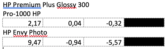

But there is another property of possible interest - just slightly adding to the complexity of this subject, it is easy to extract the black levels of the paper/ink combinations from the scanned data. I'm using just one black ink in this test - the Epson 106 ink - in combination with the GI53 CMY inks. So all data are relevant to the paper performance (I didn't want to spend the money for the Canon black ink...)
Most black levels of the listed papers vary between a L*=3.5 to 6.5 - nothing spectacular or surprising, but with some exceptions, copy paper shows an L*=27.4 which is typical, and the Epson inkjet paper is about the same. That's all no surprise. The HP Premium Plus Photo paper just gets a L*=7.86, this paper gives the ink a good fading performance but has a pretty weak black level. And the other surprise paper is the Hayatec cast coated paper with the poor fading performance mentioned above, this paper has the darkest black level in this test of L*=3.88, so the more you dig the more irregularities you find of this type.
