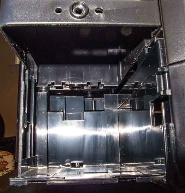

Did you take any pictures of the 840's internals (ie: up into the area the waste pad holder normally occupies)? Also if you could, could you measure the depth between that bottom and the top of that waste pad opening (minus the spacer at the bottom). I'd be interested to see if the space is as restricted as the other models I've come across so far.

Following are two pics of the Epson Workforce 840 with the maintenance tank removed:
This view is straight on showing the opening.
This view is up into the space occupied by the maintenance tank.
With the maintenance tank installed, there is a large opening below the tank measuring 3" wide x 2.75" high x 4.75" deep. This opening provides more than adequate room for removal of the tank. The tank itself measures 3" wide x 2.375" high x 4.5" deep.
Hope this helps.
Bob

Hi Bob,
That's very useful info'... Thanks...
The reason I was asking was because I took apart a Workforce WF7015 a week ago and only figured out how to install an external waste kit to it 2 days back. That particular printer had a VERY deep recess up into the printer workings of more than 6" with minimal space across either horizontal axis so I wondered if that was common. It seems not.
So definitely a useful nugget... Thanks again..
