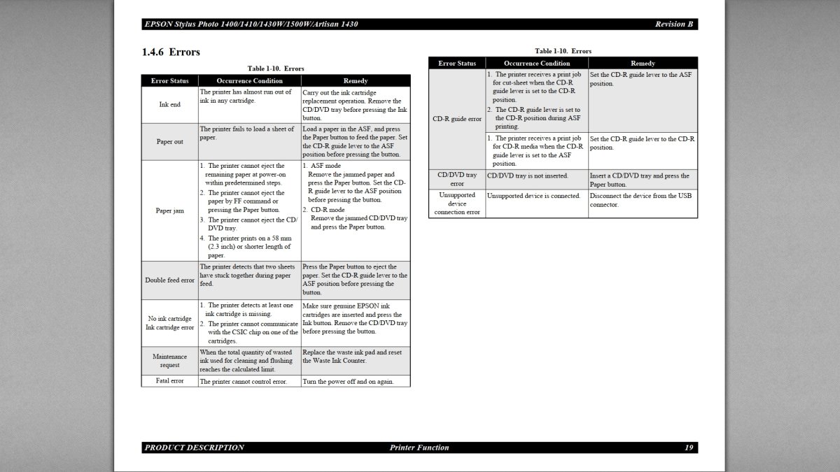

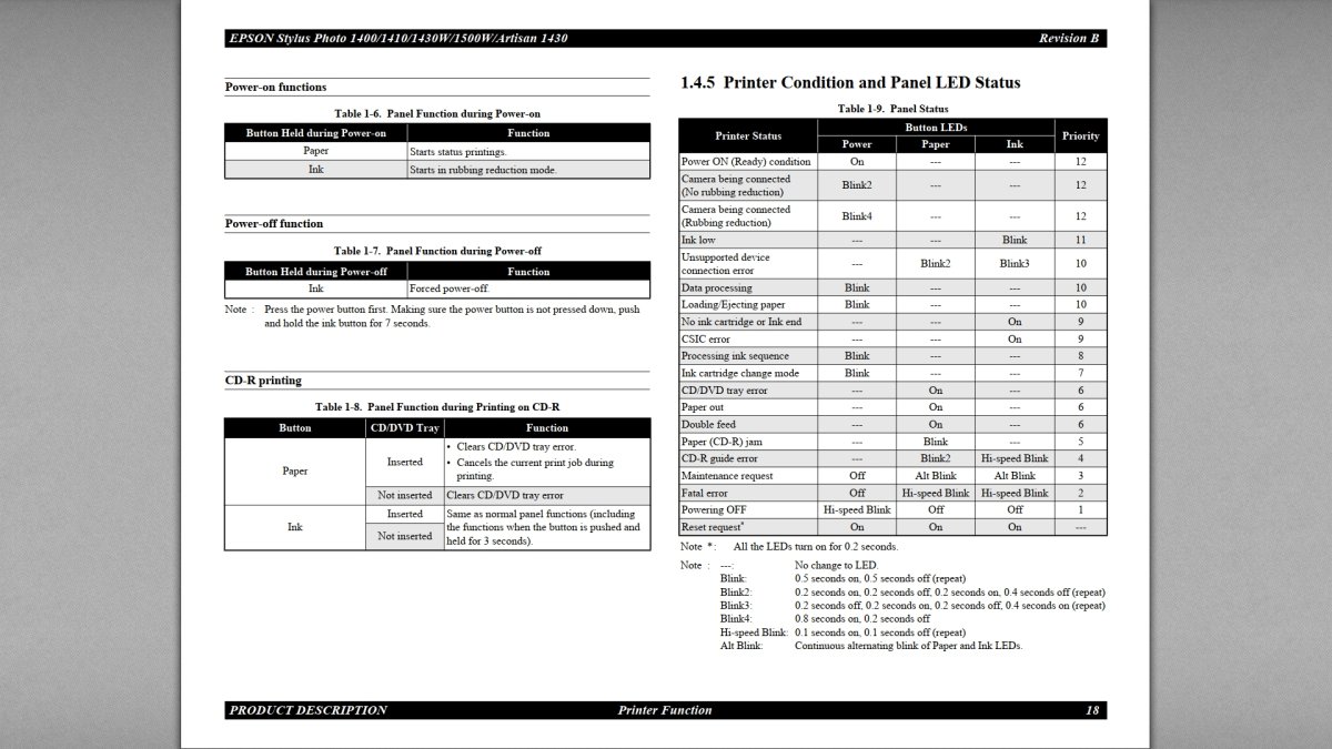

Look at which indicators and how they blink when the printer is turned on. This way you can determine the error.
I am attaching 3 files of pages from the Epson 1400 Service Manual.

I am attaching 3 files of pages from the Epson 1400 Service Manual.View attachment 15732View attachment 15733View attachment 15734
Thanks;
Only the power button blinks. .5 sec on, .5 sec off repeat endlessly while the printer head moves back and forth. I've let it go on for hours before turning it off so this is not just normal charging of inkheads. Occasionally it will stop for about 1 second then resume.
