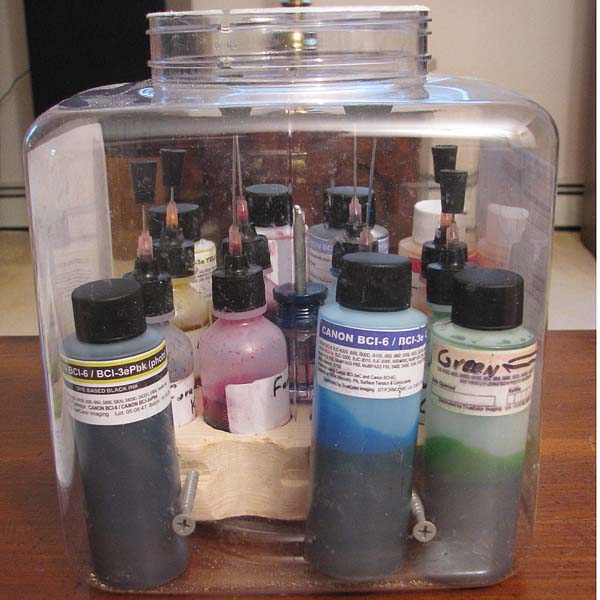

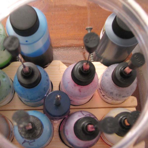

I thought that I would add something else that has proven useful when refilling (sorry for this off-topic post). With 8 different inks, it is difficult to keep the various bottles from falling over, etc., and my wife isn't exactly thrilled when I walk through the house carrying bottles of ink. These photos show an animal cracker container that has been given new life.
In the bottom are two pieces of 2x4 that have holes that hold the squeeze bottles and scallops on the back to hold the 4 oz bulk ink containers that have been opened. The deck screws keep the 2x4s centered. When a squeeze bottle is empty, it is refilled from the bulk container. When a new bulk container is opened, it is placed behind the corresponding squeeze bottle.
Benefits:
1. There is no searching for any color.
2. It is easy to see how much ink remains (is it time to reorder?).
3. With the lid firmly screwed on, any mess is contained within the cookie jar, even if I trip and fall. I may break a leg, but that is preferable to getting ink on the carpet from my wife's point of view.
You can also see the rubber stoppers used to seal the needles.

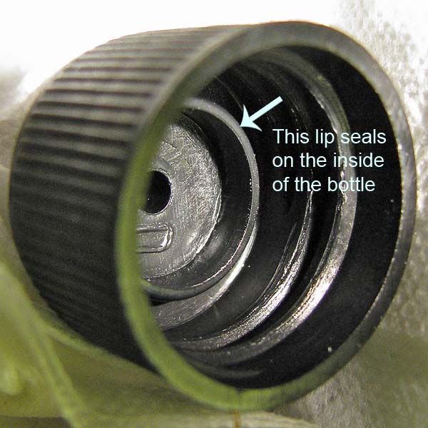

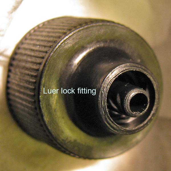

Ron350,
Here are photos of the top and bottom of a cap. You can see the lip seal on the inside of the cap that fits tightly against the inside of the bottle neck. It is possible that the cap also seals against the outside of the bottle neck, but I can't be sure. This system has worked well for me, as I havent had any leaks from any of the 8 bottles that are in use.
Thanks for the offer of the needle caps; Ill keep it in mind if my rubber stoppers act up.
