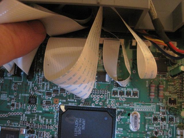

Before you can lift the printer mechanism and the electronics board away from the base, you need to disconnect the wires that go to the left side of the electronics board (near the front of the printer) that are not colored orange or yellow. On the MP780 there are two pairs of wires and on the MP760 there is just one. The picture above shows these two wire pairs for the MP780 disconnected. These wires go along the underside of the printer to the other side.

Lift the mechanism up by the metal bar that goes across the top of the printer. As you first start to lift it, some orange cables near the front need to be unpositioned from their plastic guides in the base. Note how they are positioned so that you can get them back in the same orientation. This picture shows how these orange cables are positioned and how you need to return them when you are putting the printer back together:

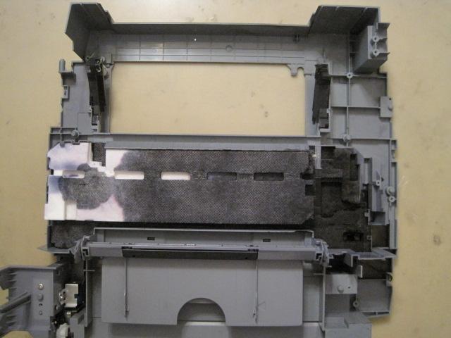

When you get the printer mechanism removed, this is what you'll see:
Now you can easily remove the waste ink pads and clean up all the residual ink from the various plastic parts. Thoroughly dry it before installing new pads. If you are interested in seeing what all the layers of pads look like, click on this link.
You may also want to remove and wash the thin black sponge unit that runs the width of the printer. Also clean the wiper blades and the two purge pads. When you put them back, the notch goes in the left rear corner.
