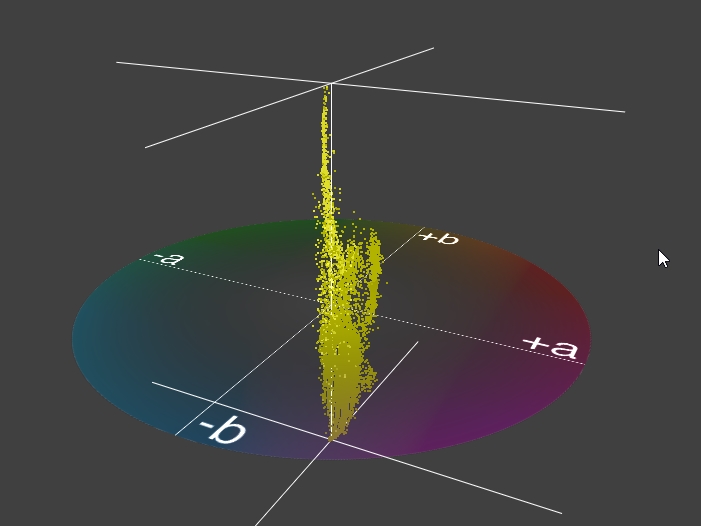

Hello again, area of concern is visible in the 'Bass Player' image. On screen I see subtle colour in the wall mural behind the player on the middle right. In my print, the chocolate browns look green and the red and green colours in the decoration are not at all vibrant- I cannot distinguish that there is any colour.
Profile in use = Adobe RGB (1998). Gamma at 2.2
6,195
7,385
Please be aware that Adobe RGB is a color space, assigned to the image, but this is not a printer profile, which printer profile are you using ?
There are practically no green colors in this image, this is the image displayed by its color values in the Lab color space - there are no image pixels with any significant -a value - the direction to more or less saturated greens.

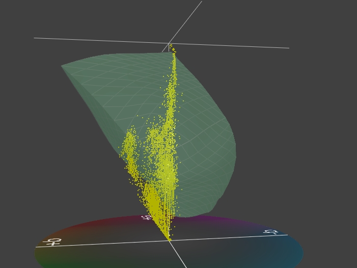

And I now make an overlay with a printer profile - for an HP glossy photo paper , this display shows that a significant amount of image pixels are out of gamut at the bottom side, this effectively means that the printer via the profile cannot handle those colors and differentiate them - printing different dark colors.
This is a principal limitation of inkjet printing - not all colors which you can see on the screen can be printed. I don't have a profile of your monitor, but you can find as well the effect that the printer can print colors which you cannot display on the screen - the color spaces of monitor and printer overlap in a rather wide range but don't completely match.
This appears to be an indication that you are using no or the wrong icm-printer profile, this needs a separate check, are there other color deviations/shifts in other parts of the test image ?
