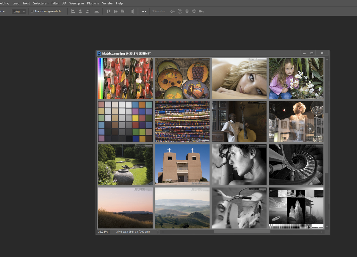

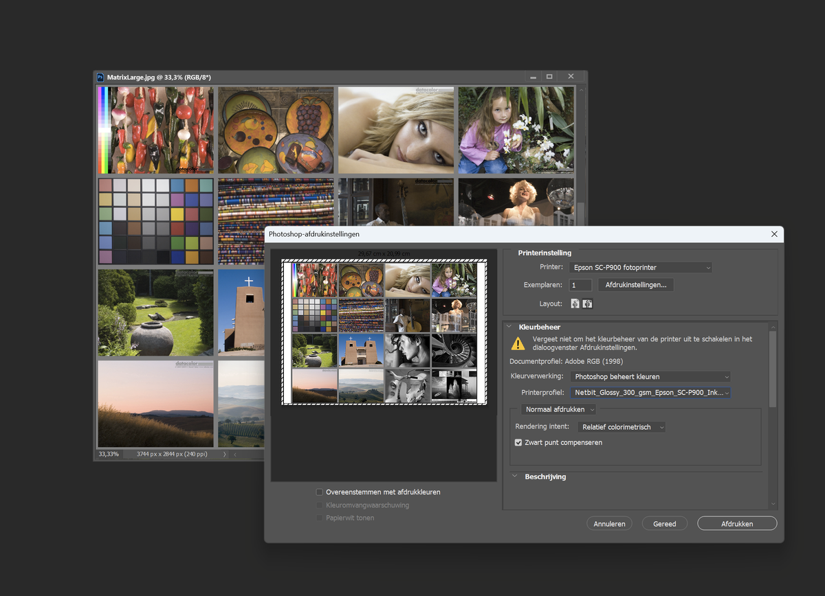

Print preview is faking you: you can see a strange color cast if you load the profile. But it will print OK. I get this when print preview pops up:
This is the picture in PS
When I load my profile and start print preview:
The print preview gives me a reddish glow on the picture (skin tone of the lady):
In the end it prints perfectly OK: nothing to worry about this.
Unbelievable!!
You are absolutely right! You saved who knows how many days of trouble! thanks

Yes it is: so just forget what you see in print preview. It is the printing that counts. ProPhoto RGB can never be printed, every printer/ink/paper/media setting combination has a much smaller gamut. Color management is just a method to translate the supposedly should-be color towards a smaller gamut output device, in this case your printer/ink/paper/media setting combination in the most agreable method, in which out of gamut colors are translated to the nearest color your output device can generate. It also will try to change the corresponding nearby colors that can be reproduced in such a way the outcome is agreable to the eye, otherwise you will get strange color ramps (this method is called the perceptual intent: it changes the colors, that can be reproduced otherwise without problems, but are nevertheless corrected so the visually agreable relation to the colors that can NOT be reproduced is maintained in the most acceptable way.
Sometimes all the colors can be reproduced by the output device: in this case the relative colorimetric method is the preferred rendering intent, because all the colors that are displayed can be reproduced by your output device.
That is in a nutshell the purpose of color management, in this case using printer profiles.
