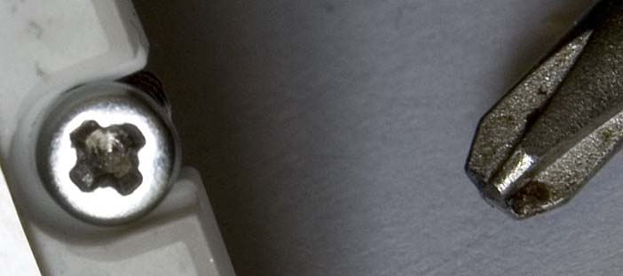

Here's something for you guys who have never seen inside one of these heads. They are quite simple heads physically until you get into the nozzle plate and that is where all the action is.

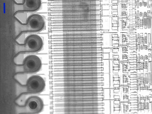

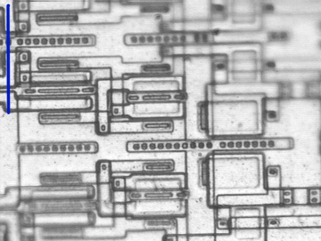

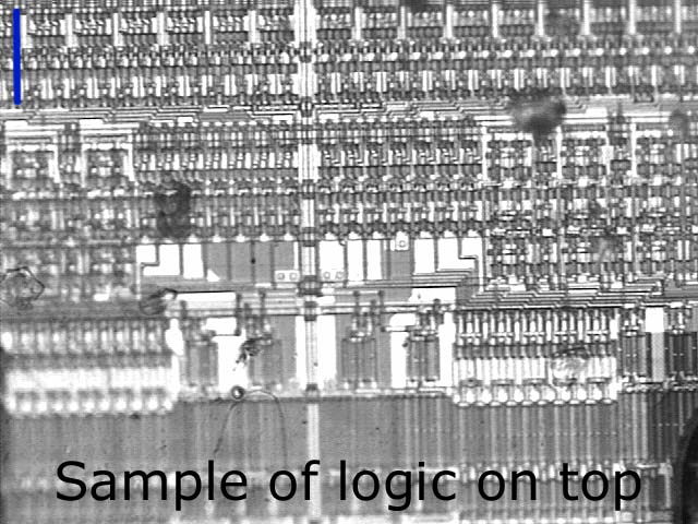

The IC that is behind the contact plate

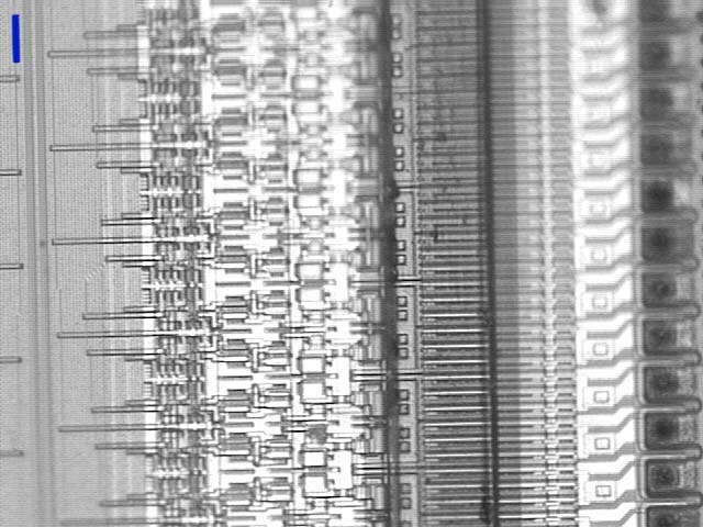

What's behind that nozzle plate/printhead plate?

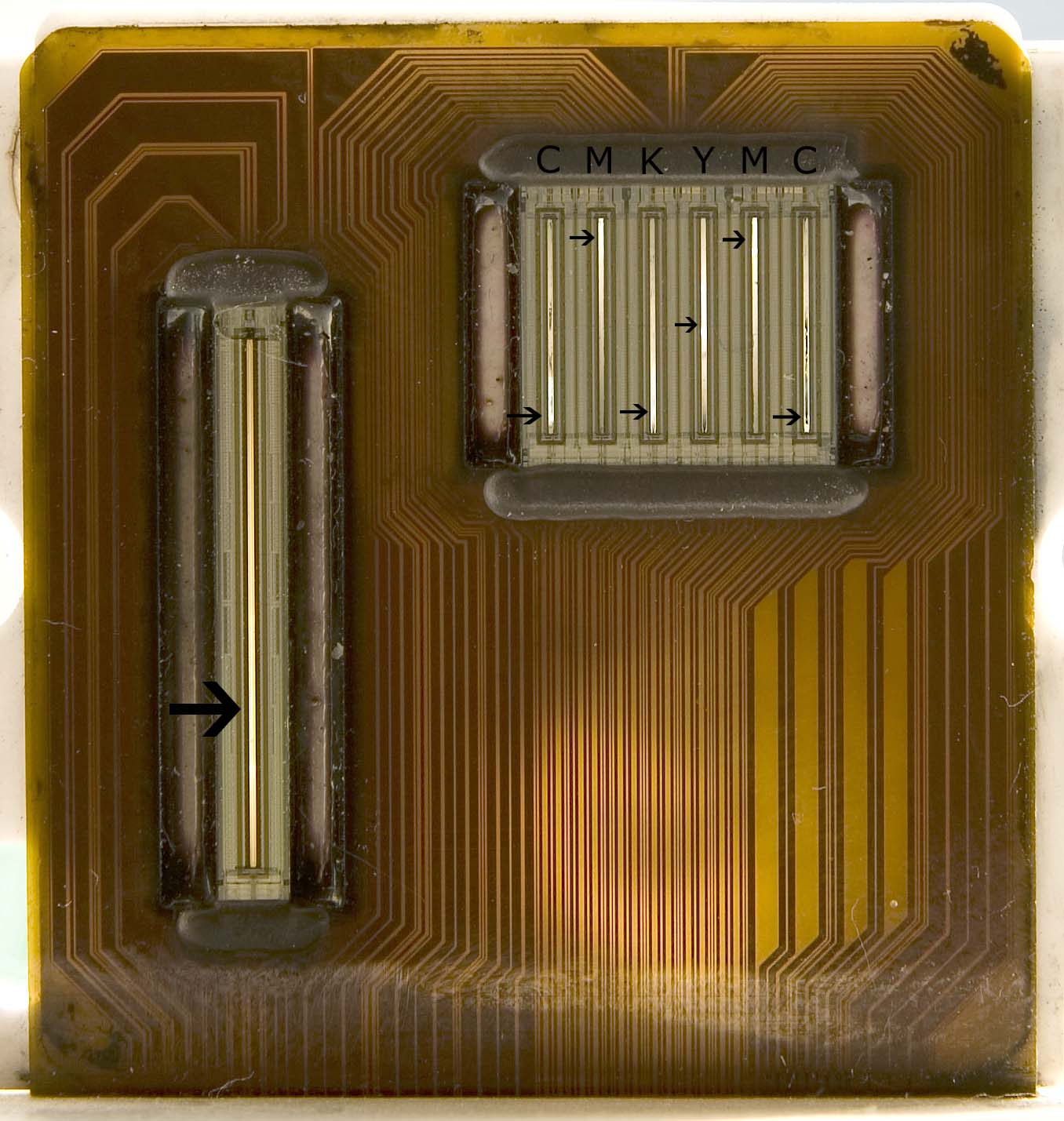

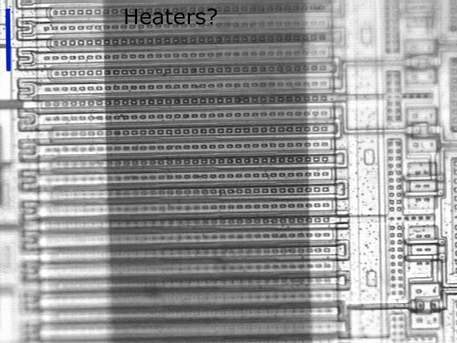

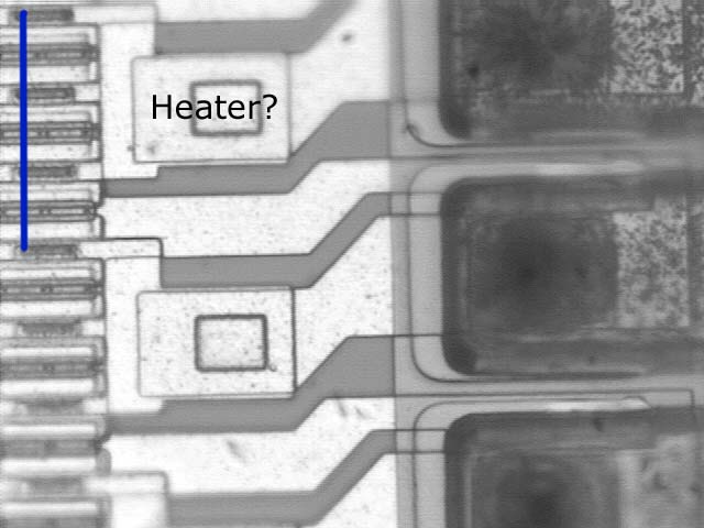

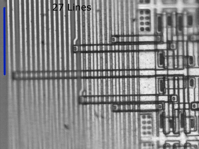

The 6 ink channels of the i950/960
Notice the wells at the end of the ink channels, these are there to maintain a wicking action and ensure that the ink is there for the head even at the end through capillary forces. If the well runs dry, you can get bad ink feed issues at the ends. Note as well that the plate is all that seals all the separate ink colors. Sometimes the plate bonding goes bad and you get cross-contamination between the colors. I must admit though that when these were taken apart, there didn't seem to be any bonding. So I wonder if the surface tension of the ink and the small gap is all that prevent cross contamination. These pics are about a year old so my memory is a bit off.
Pay attention to this, this head has 3,072 nozzles with equal amounts to each of the six colors in this head. Look carefully at the wires, there aren't 3,072 / 2 wires. Maybe someone can figure out the decoding addressing by counting the lines but it seems to me that there might be more decoding going on at the nozzle plate or maybe each nozzle is actually not separately addressed! but shoot in groups! Now this would explain a lot as to how Epson gets away with much fewer nozzles yet can retain an equally smooth gradation.
All just speculation above but interesting nonetheless.
