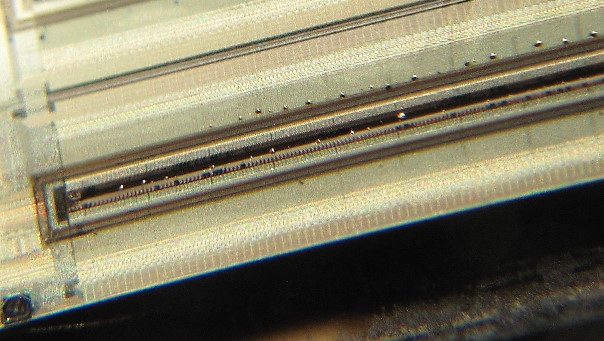

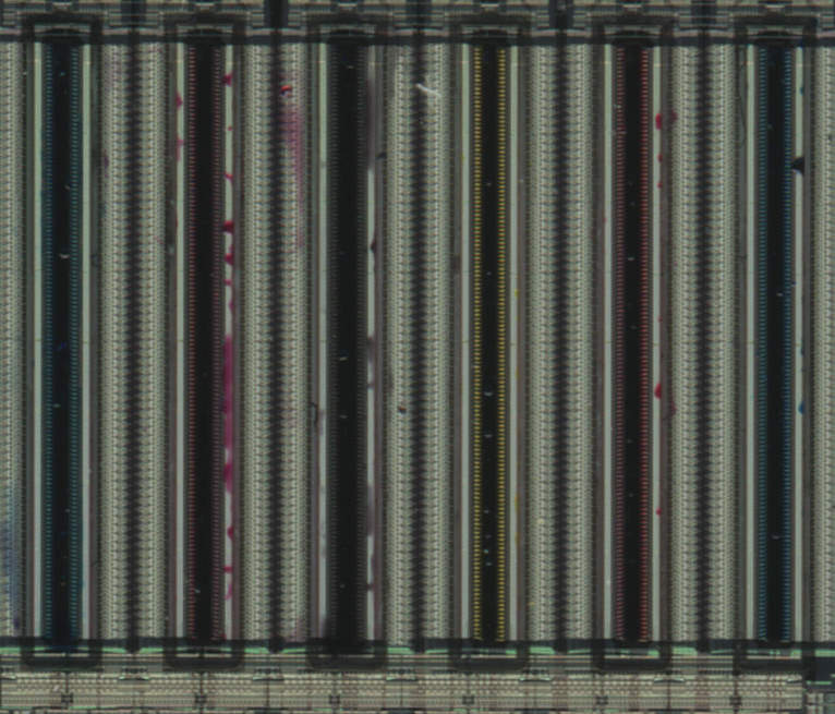

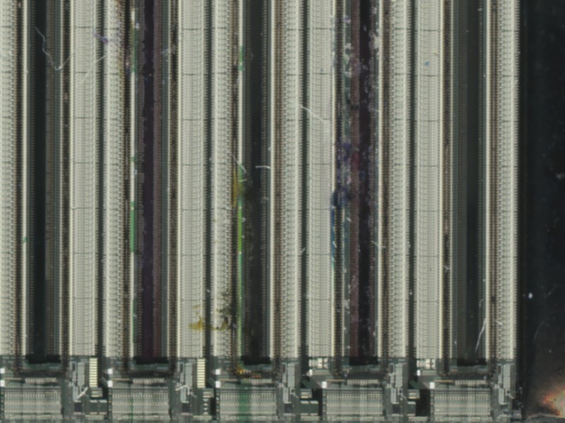

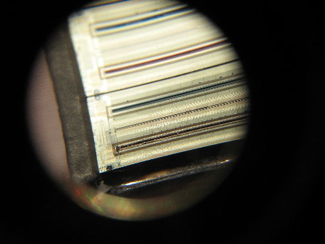

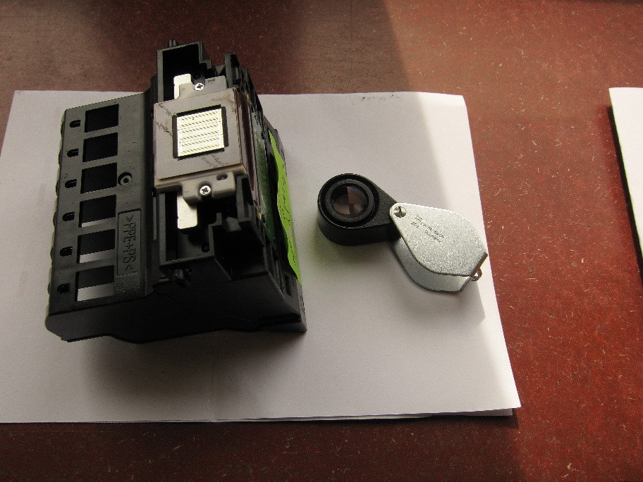

Two more techniques which I tried recently:
1 Take out the cart. put it upside down and drip the solution on the cart's outlet, so that this area of the sponge becomes white from the cleaning fluid. Then put it back in the printhead an do the cleaning cycle with the fluid in the channel. Advantage: no need to take out the head.
2 Take out the printhead and position it upside down. Then drip the solution very slow onto the nozzle plate and let it sink into the nozzle rows. Be carful do hold the head with the nozzle plate exactly horizontal so that the puddle doesn't flow over the edges.
But regarding canon printheads in general I have to say that the majority of my "clogged" head I could not get clean - certainly because too much nozzles were already burnt.
"Patience" may be important... but a printhead which did not print a clean nozzle check after 1-2 days of soaking - did not do it even after a week...
If you want to identify already burnt nozzles: some heavy defects may be visible with a simple loupe.
For magnifying I use a scanner, CCD type - others can only focus on a flat sheet - here is a good and a bad one:
qy6-0049_neu-refurb_ip4000kop1_arici10.2014_crop.jpg Qy6-0067-75_mp-elekfehler_cut_4800dpi.jpg
Or a optician loupe (20x)
I just tried to shoot what you will see:
This way you may identify heads which can not be cleaned and therefore are not worth any more efforts.
But it's the nozzle check what counts... I just had to throw away a qy6-0049, whch wasn't looking that bad under my loupe...
