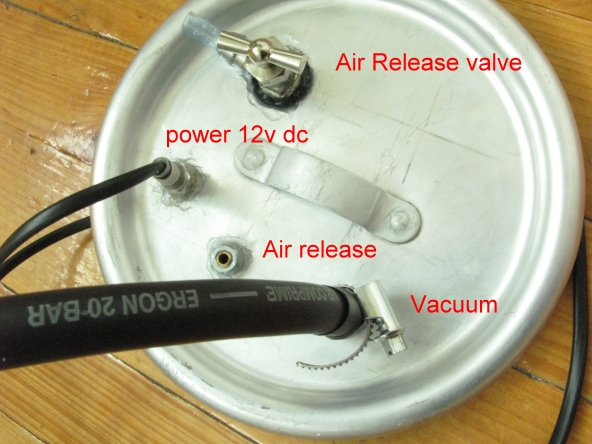

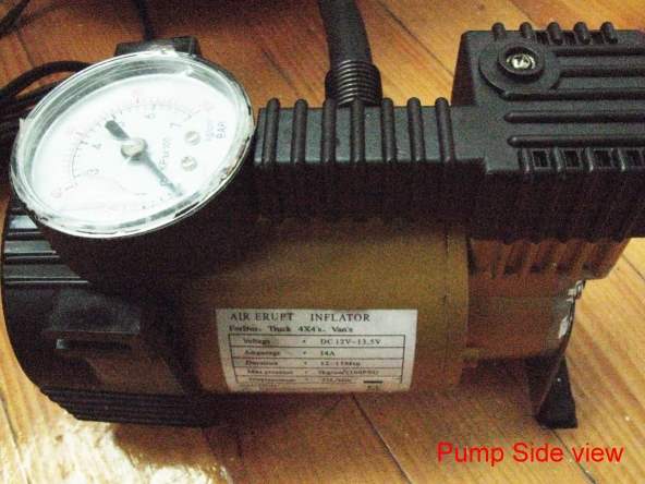

Well, I used a car tire pump to mod it to a nice vacuum pump :)
I used a 100PSI 35Liters per minute pump that has rated at 10bar.
Since I had trouble to locate the intake because it sucks air from anywhere it can I solved it by placing it inside an air tight container. I attached I monometer inside the container to measure vaccum because I could not find where to get a vacuumeter locally. The interesting thing is I can't reach more than -1bar.
Either the monometer is not suitable for vacuum measurement or I don't know where the problem can be. I think the pump should reach at least 2-2.5bar.
Here is the photo of the monometer:
And here is the container:
Sorry for not sharp photos I used my mobile to take them, will repost normal photos in a few days when my camera arrives.

You do not show where or how you evacuate the chamber.

One bar is only slightly less than one atmosphere. Even if you removed every molecule of air in the container, you can only achieve a maximum vacuum of 1 atmosphere (the pressure outside of your vacuum container is, by definition, 1 atmosphere).
Designing things to run in a vacuum is tricky, as lubricants boil off and electrical arcs (e.g. from the brushes in a universal motor) can become larger without air pressure to help quench them. Running an air compressor inside a vacuum chamber may work for a while, but don't be surprised if you encounter a prematire motor or bearing failure.

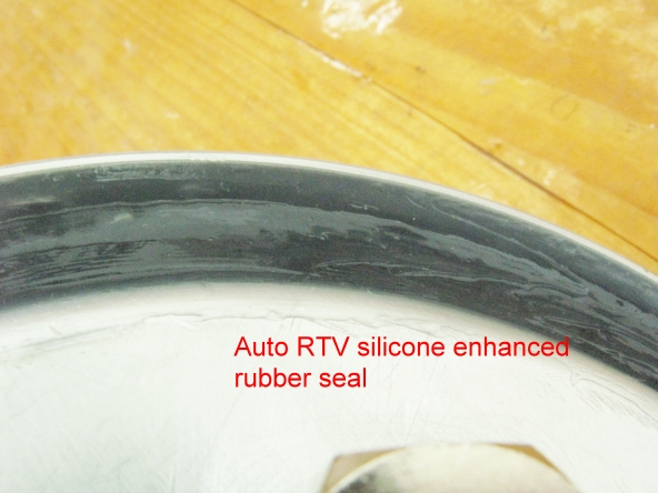

Hmm, after some research of my own you are right, the maximum possible is 1 atmosphere. About motor failure that’s possible but again, I pump down to 1 atmosphere in about 1minute 15sec. And this is not a thing I do nonstop. So if you consider how much professional pump costs that can do 1 atmosphere vacuum then even if the pump worth 38$ fails It will be cheaper to buy new than so called professional vacuum pump. Sure it's more compact ant appealing to the eye but that’s it.
Also who said the pump can't be lubricated :)
I tested that I can fill an empty container with capacity of ~25 milliliters connected to another container with water trough a tube with a thin needle (that should simulate maze part of a cartridge). That should be more than enough to fill a cartridge.
I'll repost some pictures with new camera in a few days. The inlet ports are on another side of my chamber, the chamber is made from ~2.6 - 3 mm aluminum, cause steel chamber was too expensive lol...
The Plexiglas window you see monometer trough is 15mm thick it also helps to reinforce the container.

Yes it is cheaper and I use the pump to inflate my car tires :)
Pump cost 38$
Container, sealant, reinforcement rings 20$
Intake exaust valves etc. 2$
Monometer 3.5$
Total 63.5$
Here are some more photos:
