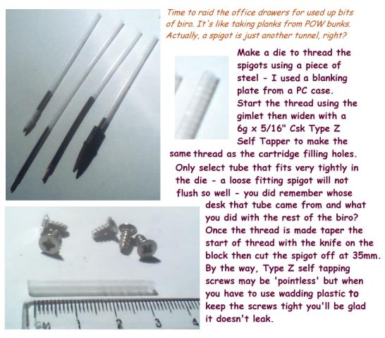

The Full Set Flusher - as promised.
Just in case the pictures failed to explain, here's the instructions for the Full Set Flusher.
1. Starting with your set of carts to be flushed, drill the top filling holes , starting with the gimlet and finishing with the screw itself
2. Then create the die in the steel plate using the same gimlet and screw size.
3. Now create the 35mm spigots making sure that only the sizes that are tight in the die are used.
4, Place the required number of pierced Fat Plugs, flange side inside, in the holes in the reservoir, taking care not to split the plastic.
5. Seal any remaining holes with unpierced plugs.
6. Screw the spigots into the cartridge filling holes, making sure they are tightly in yet not so far in that they press against the bottom of the cart.,
7. Now coax the protruding ends of the spigots into the reservoir through the pierced Fat Plugs. (Note how using a slightly smaller drill than the actual plug size makes everything watertight).
8. Place the 50pc lid the right way up in the waste bowl. (Note that this lid should be pierced to allow waste to flow under it).
9. Place the reservoir on top of the 50pc lid so that the carts rest against its sides.
10. Now fill the reservoir with warm, clean water and ensure that waste is flowing from the output nozzles of all the carts and has not stuck because of a loose or blocked or bent spigot.
11. Keeping the waste bowl emptied; continue refilling the reservoir until the waste is clear.
12. Carry out your chosen procedure for drying out the carts.

Per post #15
I would like to complete the name to The Full Set Flusher: The OMG!!!* Full Set Flusher!!!!!!!
My thoughts:
1. I cannot image the stress level if you have only one printer and you have to flush using this system. Please get a back-up printer!!!!!!!!!!
2. Vise grips?!?! Hand drill?!?!?! Screws?!?!?! Are you working on an ancient clothes washer????? No, you are working on carts. Do you intend to refill the carts after you have installed the screws??? If the answer is yes, than you will have leaks**. Please replace the screws with silicone plugs or hot glue plugs. Hopefully the holes made for the screws are not too big for the silicone plugs. If the holes are too big for the plugs you will have to use the hot glue plugs. If you can use the silicone plugs please see if you need the regular cap plugs or the low cut cap plugs. The low cut cap plugs are for printers that have clearance problems.
In my mind using screws is like what they say about concretecrack or will crack. With screws it isleak or will leak!!!! Every time you remove a screw for flushing or refilling you are wearing down the opening/threads. Eventually you will have a leak(s).
3. How many holes do you make in each cart? It is hard to follow your instructions to see how many holes you make in each cart. You should make no more than two holesone hole if you are using the top-fill method and two holes if you are using the german method. In short, more holes, more leaks!!!!!
Thank you.
