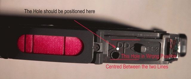

It works on the principle of siphon and gravity, no hole needed and if you're ever drilling a hole make sure its centred on the > (best spot).

Maybe I was using a dull bit but I was surprised how much drilling it took to pierce the cartridge. A few times, I ended up with leaking cartridges, although it wasn't as if the bit had gone all the way through the cartridge and out the other end of the bag. When I took one of the carts apart, I noticed that the plastic case had intruded (extruded?) into the bag. I wonder if I didn't cause some separation between the bag and the wall of the cartridge.
Another minor inconvenience was that I ended up with a raised ridge of plastic where I had drilled. This needed to be filed down so that the glue gun could make a flat seal.

When you drill the hole it only needs to be 4 to 5mm deep no more otherwise you risk tearing a hole in the bag, which will render the cartridge useless.
No need to file the drill hole eider a little raised surface doesnt matter if the hole position is correct, those cartridges are not in fact airtight, their just used for easy handling and to hold the inner bag and counter weights in the correct position..

This may be a dumb question but what type of drill do you use? I was holding a Black & Decker drill about the size of a ski boot in my right hand and the little cartridge in my left hand. Would a Dremel do the trick? Also, any particular type of bit? I was surprised how long it took me to drill the cartridges.
