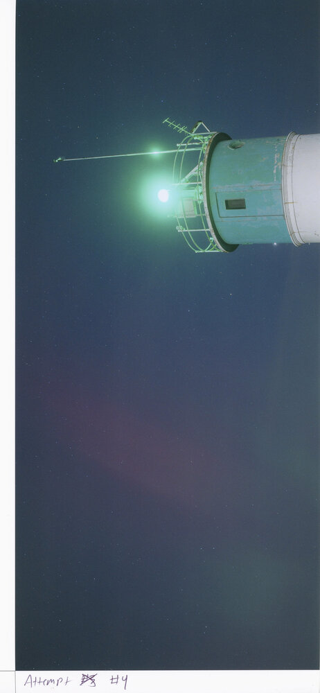

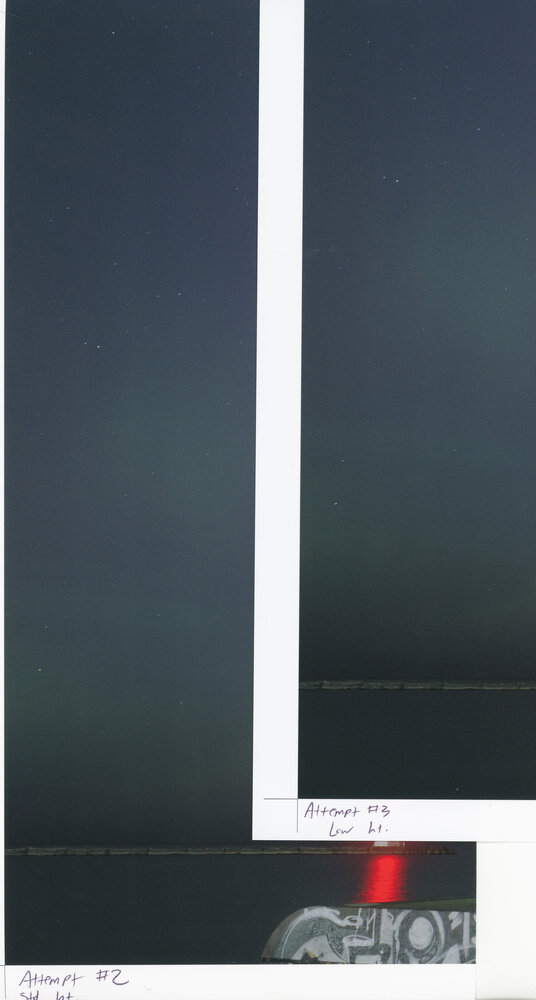

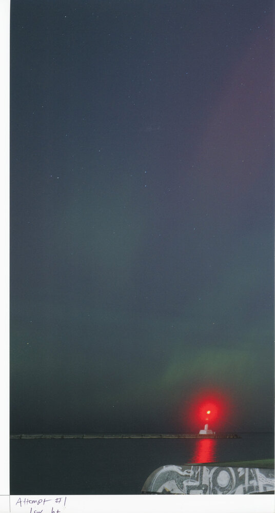

I've made four attempts to print with the same results: as a 12x18" in the first three (line runs vertical to the photograph's orientation), and as an 8x12" in the last (line runs horizontal).

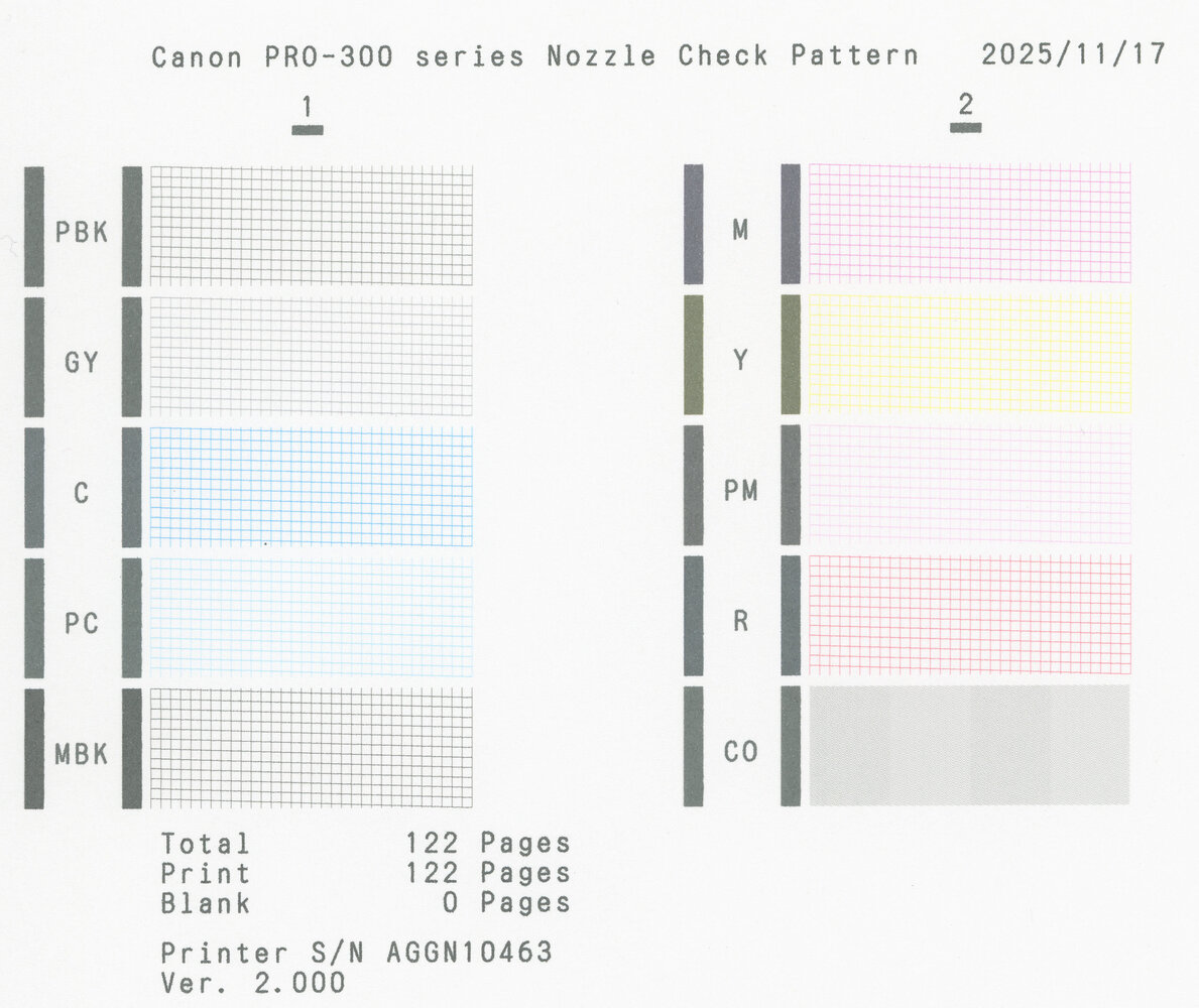

Here are scans of those attempts, along with the latest nozzle check -- in all scans the lines are oriented on the left side of the frame. In all cases I cancelled the print before finishing.

• I've followed maintenance steps noted in the earlier thread: nozzle checks, head. and bottom plate cleaning cycles.
