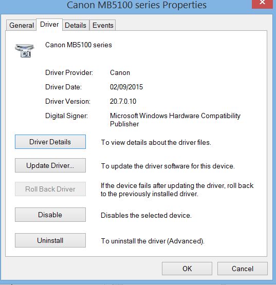

when I attempt to update the firmware it still states the printer cannot be found.
For Christ’s sake DON’T upgrade the firmware whatever else you do, you will destroy a perfectly good printer..
Now that you have a working printer and driver you can if your still not happy with the current driver try and see if there’s an newer upgrade available, again I say, Don’t upgrade your printer Firmware..
It does install a Windows driver, just not a Canon driver.
Just go into Properties and you can upgrade the driver from there, as shown in the Pic below..
The Firmware Version only appears on the Nozzle check when the printer is locked and is unable to enter Service Mode..
Capture.JPG click to enlarge..
P.S. you are fortunate to have one of the first Pro 1 printer that can be refilled and reset the waste ink counter, so don’t try to enter Service Mode unnecessarily, because the printer will lock you out if you mess with it..

That's what was in Canon's documentation regarding firmware, it was to perform a nozzle check and check the bottom for firmware version.
I had previously attempted to both update the driver from the Windows installed generic driver to no success. I had both attempted the automatic update and manually uploading the .inf file.
Surprisingly, this morning when I attempted again Windows updated to a Canon driver (yay!).
I had left the printer on overnight (which it shut itself off after the 240 min window) and just turned it on and attempted the driver reinstall.
I appreciate the help
