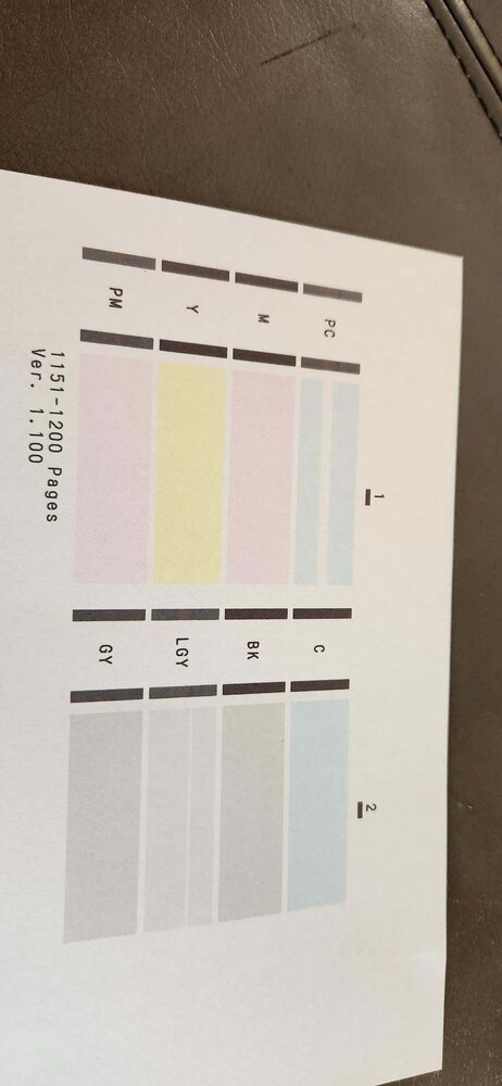

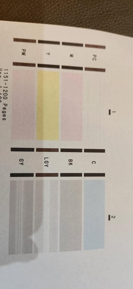

So completely confused now. The first image is where I started off, after numerous auto cleaning and manual cleaning got image number 2. That is when I contacted this forum. I changed the PC and it still stayed at image number 2. I have left this a week and now have image number 3. The PC and the LGRY are almost perfect. If you cant see from my photo number 3 has a feint line on PC and LTGRY which is still giving me a subtle lines on a photograph. I am now loathed to buy a new printhead, as it is nearly cleared. From what I have done, including leaving a week, can you deduce what the problem is. I haven't replaced the LGRY cartridge and that is also better. Can you deduce that a new printhead is not the problem, basically how to now proceed.
