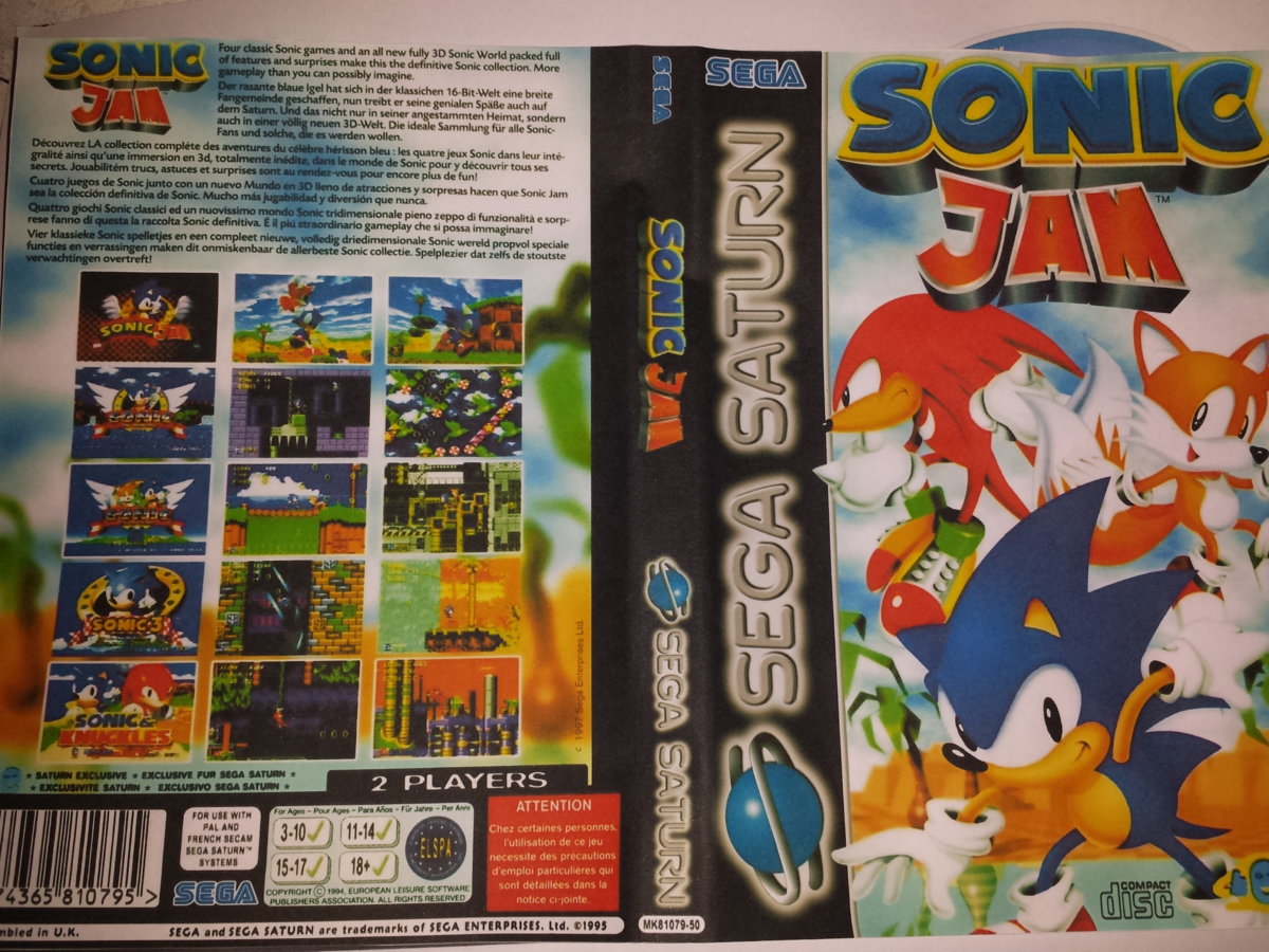

Take a look at this game cover i printed few days ago, small text on back side is fine when black text is on blue background (it is a little blurry but im only saying that because i have mp620 too and when i compare prints from mp620 ,that has no problems, to 630 i see the difference ,biggest problem is white text on black background its that blurry that it is so annoying.

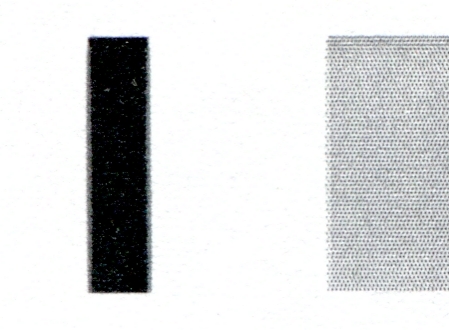

The nozzle check uploaded in the first post in the thread linked to by stratman shows a print head with damaged nozzles for pigment black. A somewhat similar damage to the nozzles for dye (photo) black looks exactly like your dye black nozzle check.

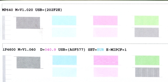

I have two printers that use the same print head as the MP630. One is a MP640 that has done 4135 prints and an iP4600 that has done 981 prints. Strangely the MP640 has the best print head.
Here is a crop of scans of extended nozzle checks from service mode for the two printers, notice the difference in the dye black stripes:

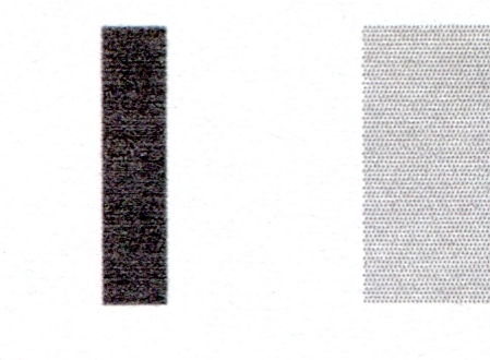

Here is a crop from the dye black regular nozzle check for the MP640:
And for the iP4600:
Only a new print head will make the MP630 OK again. The type number for the print head is QY6-0072. If you want a new print head only buy it from a regular dealer of Canon spare parts. Do not buy an E-bay offer from a seller from the far East. These print heads are often used and defective print heads that have been cleaned to look like new and packaged in counterfeit aluminium bags and cardboard boxes.
