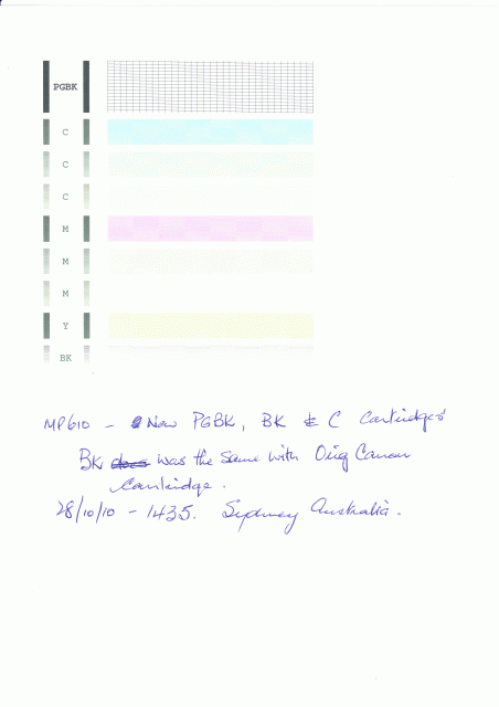

My Canon MP610 prints photo-copies from the platen OK but when printing photos/pictures from the printer driver there is no black what should be black prints as purple. Why is it so and what can I do about it? I have had the problem for several months.

1) Print out a Nozzle Check, scan it and post the image on this thread. Also, you can scan and post an example of your printout problem.
2) Do you refill your cartridges? If so, what brand ink, what method of refilling, what cartridge are you using (OEM Canon or a third-party), how many refills on the cartridges,and how often/when was the last purge of the cartridges?

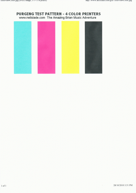

Finally... It took me several tries to convert the upload to an acceptable .PNG file.
I think I may have discovered where the problem sits. The BK cartridge seems to be not firing very much.
This was a genuine Canon (full) and when I replaced it with Skyhorse it is still showing the same pattern.
I also had to replace the PGBK and Cyan cartridges (Skyhorse) because they were critically low.
Because I'm basically lazy I haven't kept a log of the cartridge replacements but it appears to me that it has been a looooong time since I replaced the BK cartridge and it was still pretty much full.

Jim:
Congratulations on posting your scans.
Unfortunately, the images you posted are a little small, so, could you please rescan the printouts and crop the images down to just the printed area minus all the unprinted white paper surounding. In this way, we may be better able to see a magnified image of the nozzle check and purge test pattern and give you a more educated hypothesis of your problem(s).
