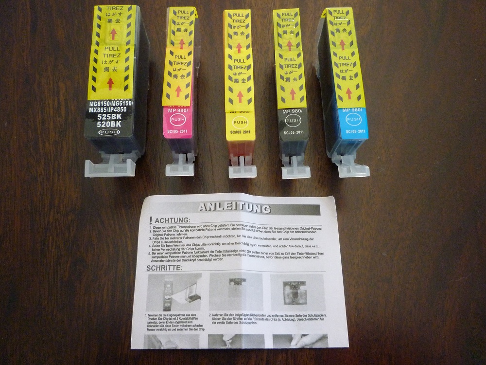

Thanks for the suggestions there, I'm reading as much as I can before I start refilling the german way so thanks for the input. Not sure if anyone has purchased these clear cartridges from Sudhaus in Germany but I was interested in those in particular. Price with postage seems quite reasonable. Have purchased the ink already and syringes.

Those cartridges are transparent, which would be advantageous for refilling since you can easily see the the level of ink. I don't know the quality, performance or durability of these cartridges for refilling. If you do use them for refilling, post your experiences over the coming months/years. :)

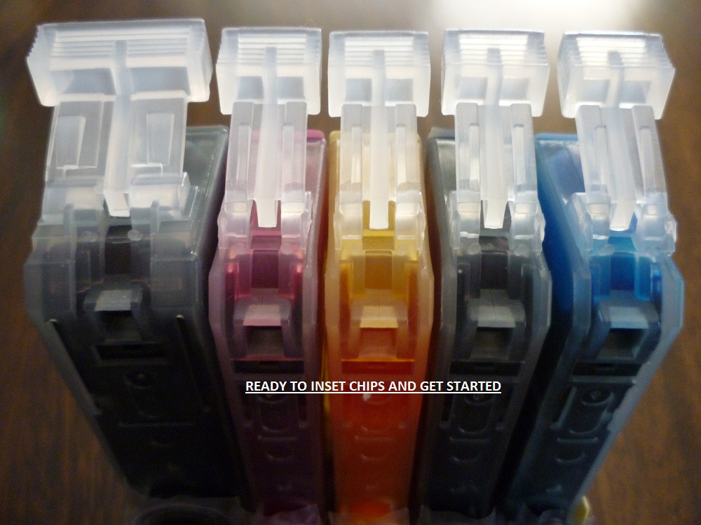

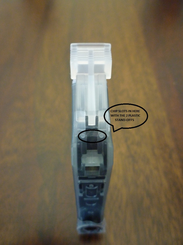

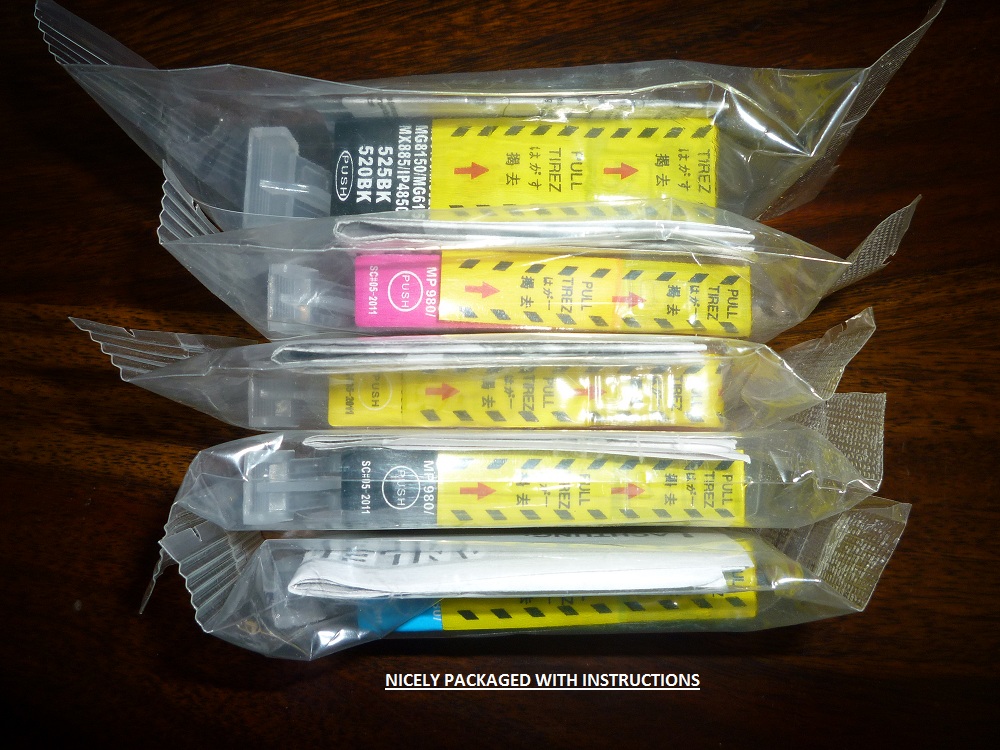

Well just when I had all but given up, the German carts arrived. Maybe something to do with Paypal getting involved. Anyway will post some pics soon and let you know what I think.
