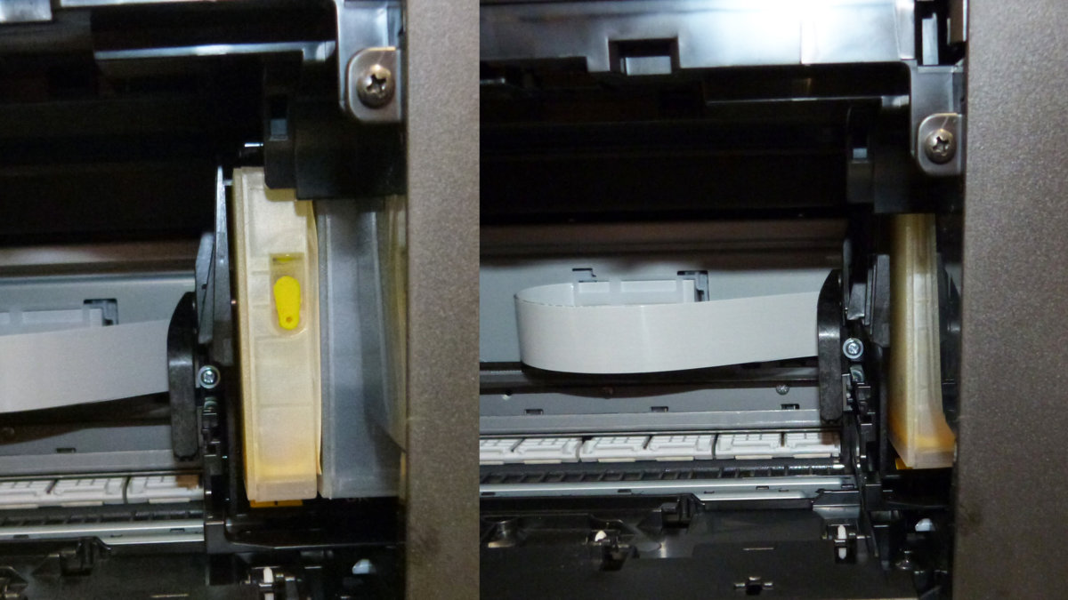

OK in all your videos, especially the first one in post # 1 they show your cartridges in the un-locked position, so the print head should be able to be pulled into the centre of the carriageway.
Here is the position of my cartridges when in the un-locked position (Left Pic) and (Right Pic) the locked position, now compare that to you carts position from your video Pic.
Maxify.jpg... Your Maxify.jpg click to enlarge.
You can stick a piece of paper in the door micro switch on the top left side of the printer, this will enable you to operate the printer while the front door remains open, which should give you a clearer picture of what’s going on.
Another thing you can do would be to put your hand in to the left side and rotate the white gear till you hear an audible click that might also help you move the printer head by hand...

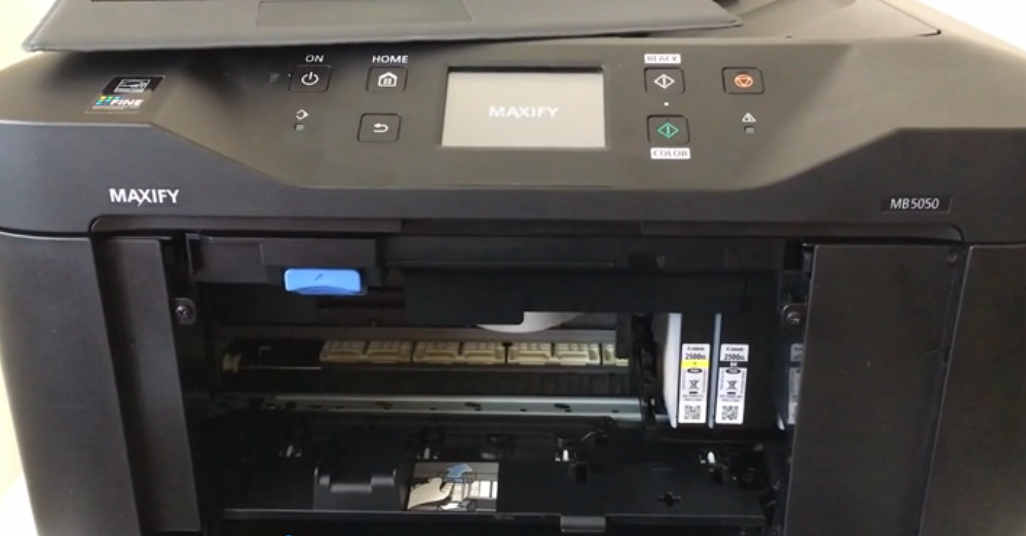

Hi,
I got this printer from someone that hadn't used for quite some time and even when first connected it was barely used (some kind of unwanted gift).
After turning it on for the first time, I got the language selection menu and maybe one or two other options after, but it then went to an error screen (error code 5102). Here's a video of the start up process (right after pressing the power button):
https://www.dropbox.com/s/afx0f7ovnn90td8/IMG_8693.mp4?dl=0
The error message suggests checking for any paper jams (there isn't) or to see if the cartridges are properly set, which I can't do (the printhead never moves to the center, even if I wanted to take each one manually).
I have also tried to enter service mode, but it didn't make any difference. The cartridges are Canon original.
Should I consider this one is toast, or at least in need of service repair?
Regards
It seems to me the printhead is blocked after moving 2 carts to the left.
It moves from the locking position so if you pull the plug at the right moment you must be able to glide it further to the right and feel where it stops.
Are you really sure all cartridges are seated well ?
Maybe you could remove the right side panel to have a look (@The Hat knows how ;)).
