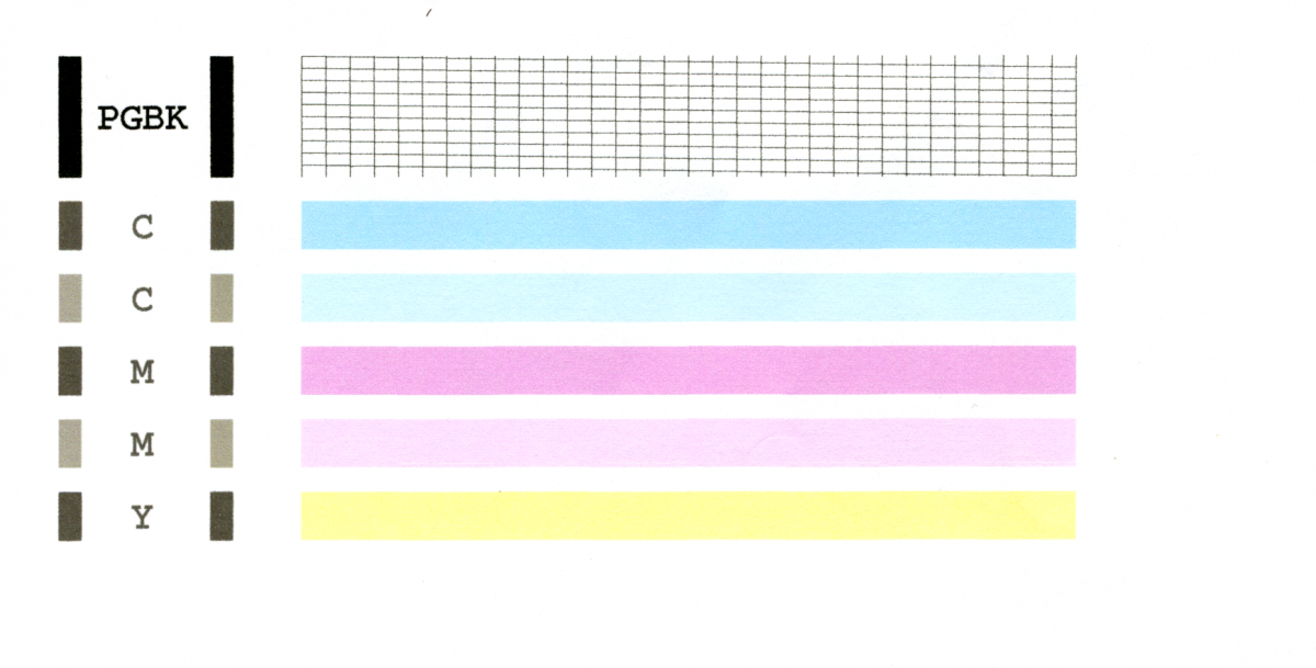

Hi Christina,
It sounds like there’s a lot more going on in there that you can imagine, firstly you say your nozzle check is ok, but you also say that your text is not black either.
Can you post a nozzle check for us to examine and then we will be able to give you a much better idea on what’s going wrong on you, but please don’t print any more test prints or word documents till you can resolve this problem, only nozzle prints are acceptable at this time.
This is what your nozzle check print should look like..
View attachment 1454 click to enlarge.
