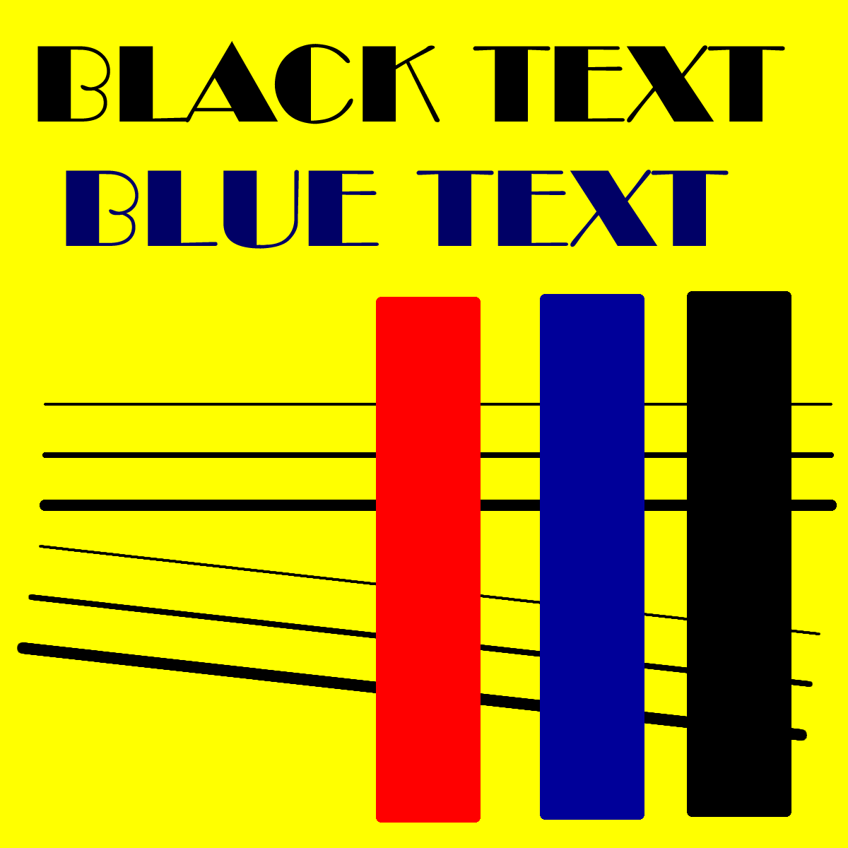

Update:
To show you more of what I'm talking about regarding single / bidirectional printing (Photo and Plain paper settings respecitvely) I did a quick and dirty test.
Below is an image I created in Macromedia Fireworks to show the bleed. It is a large image but I printed it at 3 inches square so I could print them side by side and scan it.
The left side is plain paper mode while the right is photo paper pro mode. The paper is super cheap staples multi-purpose paper.
(Click for larger image)
Feel free to run the same test yourself, here is the original image (printed at 3").
http://www.nifty-stuff.com/color-test/color-print-test.gif

Okay, I know I'm beating a dead horse here but...
Here is the same test but with a white background. As before, the left side is plain paper mode while the right is photo paper pro mode.
Notice there isn't as much bleed when the black isn't against another color. Still, the photo paper mode does make a difference in the amount of bleed.
