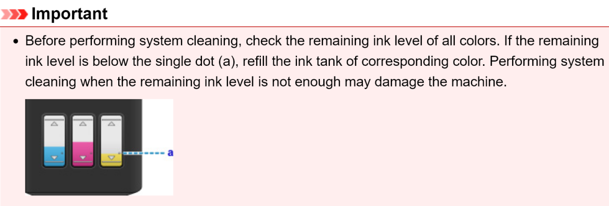

If the ink is low in the tank, but not completely empty, then add ink till above the "single dot".
Read more at https://support.usa.canon.com/library/ij/ErrorCode/G2000 series/EN/ERR/5200.html
Error 5200 concerns ink levels. As I recall with Canon tank printers, you have to manually set the printer's ink level monitoring to "full" after refilling. There is no automatic sensor for sensing "full". If this sensor was not set properly then the printer continues to count down to zero ink and then stops even thought there is more ink in the tank. This should be described in your manual.
https://support.usa.canon.com/library/ij/Manual/All/G2000 series/EN/BG/bg-ink1000.html

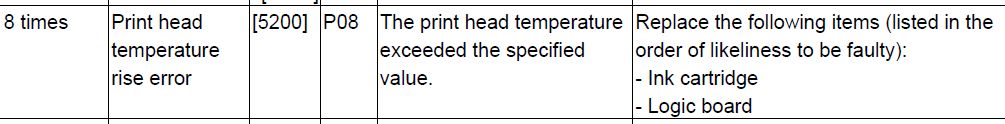

There seems to be no service manuals available online for the G2100 printer, but a service manual for an older two cartridge printer MP280/MP495 shows that the error 5200 means printhead overheating. This error code seems to have this meaning in all available Canon service manuals. The suggestion is to first change the offending cartridge (print head) and second the logic board.
Here is a clip from the service manual:
So it looks like you will need a new colour printhead. I don't know the cost and availability of a new print head, so maybe it is time for a new printer?

Thank you for the information.
The color tanks are half-filled, I don't think I need to add more ink for the moment.
So, this "system cleaning" apparently consumes A LOT of ink. Should I do it if the “Cleaning” and “Deep Cleaning” didn’t solve the problem?

Thank you. But how can the printhead be overheated if I rarely print in color? In principle, I suspect the problem is due precisely to lack of use of color inks. Am I wrong in thinking this way?
I do not know. It may be the solution. If you do then fill the tanks to full to have plenty of ink. I read it consumes ~1 inch of ink in the tank. If ink runs out then the print head may suffer permanently burned out nozzles.
