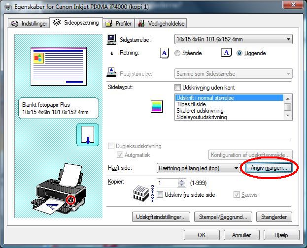

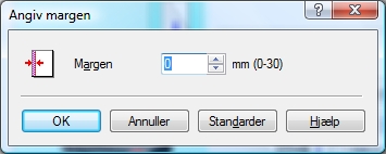

The Danish "Angiv margen" translates into "Set Margin" or similar, my OS is Danish, I don't know the English Microsoft term. Clicking the highlighted button gives this dialogue box (click thumb to enlarge):
I am allowed to set margin to 0-30 mm. This is for a Pixma 4000 connected to a Win Vista 32 bit desktop computer. I have done similar tests with Pixma 5200 and MP 540 connected to a Win 7 32 bit laptop. I get the same 0-30 mm margin limits.
Is this your problem? You are limited to a 5-30 mm range?

I am allowed choose margins in all but two of my printers and have the same dialogue box as you have shown for specifying margins.
Regardless of what figure I put in to this box I am still limited to 5 mm it has for some reason defaulted
to that figure in my printers even the ones that dont have the ability to specify margins.
When I click to print a sheet Explorer brings up a Canon print window like this one below and by clicking on properties
can further change the print setup to my own satisfaction and all of these little print windows are displayed in Explorer also.
