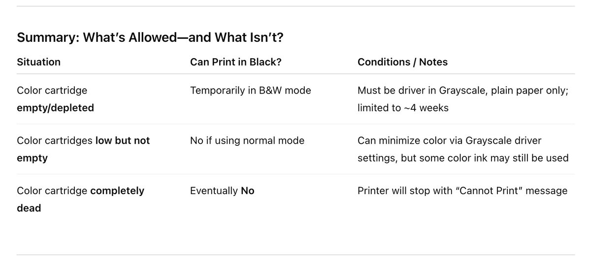

I don't think your printer supports just B&W with the Black cartridge only over the long haul. Here is a table from the web summarizing what can be done:
Over the long haul, it would less expensive to use a B&W laser printer for your needs. Less expensive per page and you don't run into any ink cartridge issues.
Just some quick thoughts
