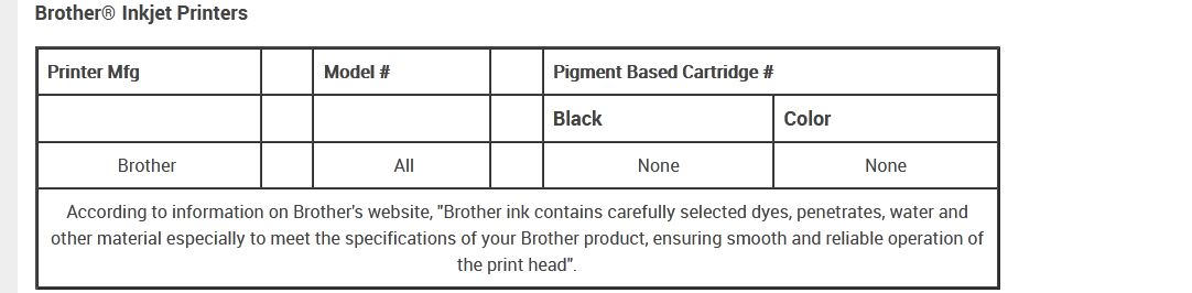

I found this while looking for pigment ink printers for Brother, HP, Canon, Epson, Kodak. Does this mean all Brother Printer are capable of providing the same elements that pigment ink provides using Its own Special "Brother" ink? Please help!
I don't know source you are referring. However, they must be talking about their dye sublimation printer series. Most of the brother printers are dye printers, and dye printers don't need pigment ink even if its HP, canon, or Epson.

I don't see where the above attachment is coming from and whether we are discussing in general the use of a pigment black in Brother printers or whether it's specific for a particular model.
I'm just looking to the Brother DCP-J1140DW, this one comes with CMY dye inks and a pigment black. Brother printheads like Epson printheads are piezo printheads, they just have one nozzle row per color and control the droplet size electonically, and all nozzles can deliver the same droplet size. This is different to Canon printers, the pigment black is running with much larger droplets - about 20pl - to allow fast printing, but such droplet size is useless for anything else than text printing so it is limited to the normal paper selection, and is even here not used for duplex printing and borderless printing. CMY colors are printed via separate nozzle rows with droplet sizes in the range of 2.5 to 5 pl including a dye photo black if available.
So yes, there are Brother printers with a pigment black and CMY dyes where you can replace the pigment black with a dye black and use a matching paper selection which prints with the black channel. This delivers very good photo prints indeed as mentioned by @Smile - (it may run a little bit slow nevertheless)
