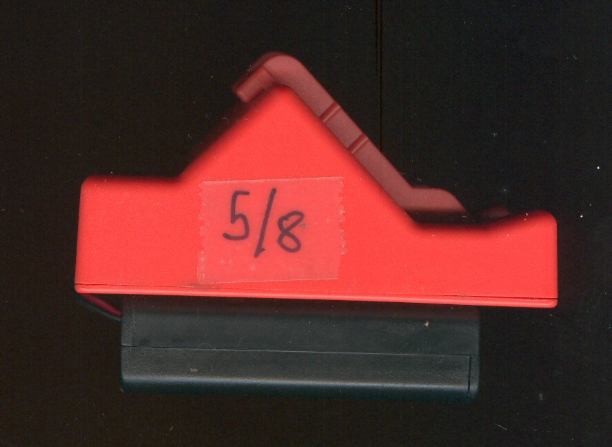

Here is a scan of my first generation Redsetter with a 2xAA battery box attached using double sided sticky tape, click to enlarge.
The two alkaline AA cells show a no-load voltage of 3.19 V dropping only to 3.17 V during a reset, indicating that the internal resistance is much lower than for the CR2032 Lithium cell. I hope that battery problems are now a thing of the past with the alkaline cells. In my opinion the added battery box doesn't make the Redsetter less convenient to use.
I could also have made the Redsetter USB powered by using 3 silicon diodes like 1N4001 in series with the USB 5 V supply voltage. These diodes are rated for 1 A and the current that can be drawn from a USB port is limited to 500 mA. An overloaded diode can short out, meaning that the voltage drop will be zero, the use of 1 A diodes makes this approach more fail safe. Remember to add a load resistor like 1 k Ohm across the battery terminals to keep the voltage down. The 0.6 V voltage drop across a conducting silicon PN junction is only a rule of thumb, actually this voltage drop is current dependent, and for low currents it tends to go towards 0 V meaning that you will have almost 5 V across the battery terminals. The voltage should drop immediately when current is drawn, but does the Redsetter contain any capacitors? Better play it safe and include the load resistor to protect the Redsetter from overvoltage.
The reason I chose the battery box instead of using a USB cable from a defunct mouse + 3 diodes and a resistor, is that I like the "cordless" resetter much more than the USB powered versions. I think the USB cable is an inconvenience. If you don't mind the USB cable I recommend buying a USB powered resetter for long trouble free service.
