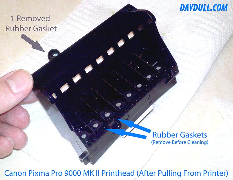

bout the only thing I haven't looked at is the seal between the cart & the printhead. I don't know how to evaluate that & one would think a new printer with OEM carts would not have a problem there.
The gaskets might get unseated during a flush of the print head. Maybe it is a manufacturing error in your case. Turbguy's suggestion of a new print head may be the final course. But not yet unless you are done investigating further.
http://daydull.com/tips-tutorials/how-to-remove-a-canon-printhead-how-to-clean-a-clogged-printhead/

I will try manipulating those seals a little since it's a free effort. It seems like there would be ink leaking past them when the printer's off if they were not sealing.
