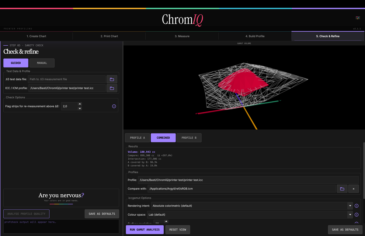

I am working on a similar project but have not gotten much feedback here yet. My app ChromIQ is a GUI for the printing part of Argyll. In the beginning it was MacOS only but in the latest beta releases it works with Windows as well (but might still have some issues). I don‘t have this nice comparison view that you offer but I managed to create some profiles with it.
https://github.com/itsab1989/ChromIQ
This video is from an earlier version of the app. I made it for the person (Thanks again Knut!) who inspired me to do this and it shows the measurement and refinement process (more experienced users will probably not need this):
It looks waaayyyyyy better than mine! You clearly invested a lot of time in this. I just used the most common options for rgb printers
