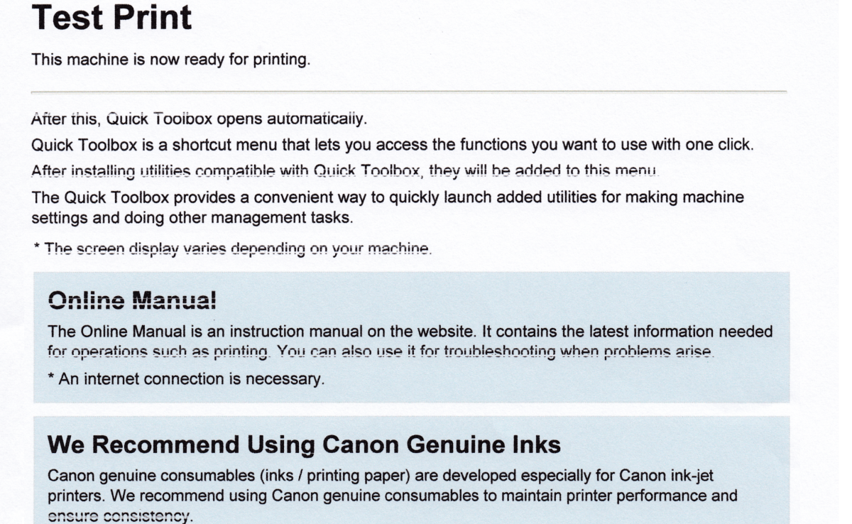

AS requested @PeterBJ
I did managed to get a Maxify 2350 for €129 this weekend to try it out, once connected to the computer, Windows installed the complete drivers but I did try the CD later, just out of curiosity and it installed a load of junk on the hard drive not to mention several serious open security risks.
Here is the very first test print that came out, it was not great so I was forced to run a head clean, which solved the poor black output very quickly, I removed a little bit of colour from the centre of the print, because the colours worked fine.
Scan Print2.png click to enlarge.
It came with the small 1500 setup cartridges which have probably 7 or 8 ml of ink in them and it took more than ten minutes of flapping around before it got to the auto head alignment.
It’s a fairly bulky and noisy printer but it does print very fast and the print quality is nice and sharp, it has two paper cassettes that can hold several hundred sheets of paper, it has a foot print of about 46 x 56 cm.
It would probably appeal to a lot of guys because it comes with all the bells and whistles, USB, Ethernet, Wi-Fi and a fax also, on top it has a scanner, ADF and Duplex, with a duty cycle of 15,000 so a good all round office printer.
I will probably end up giving it to my grandson because apart from its ability to print fast, there is nothing else for me to get excited about, and I will likely get refillable cartridges for it too..

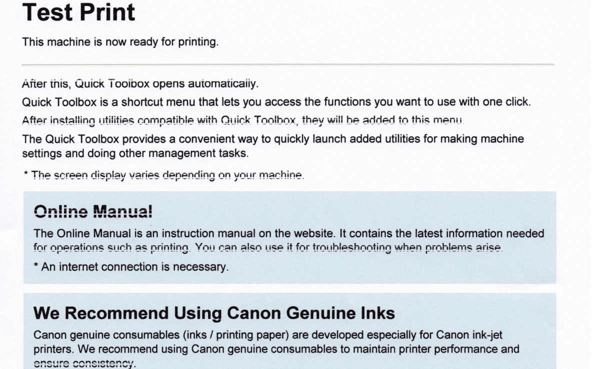

View attachment 4051 click to enlarge.

OK Mike you have convinced me, I’ll get a set of compatibles from you in the coming weeks, the setup carts wont last long at the speed this thing can churn out sheets, I tried and used the copy facility today and it finished the printed sheet almost as quick as the original copied sheet came out of the ADF.. :eek:
