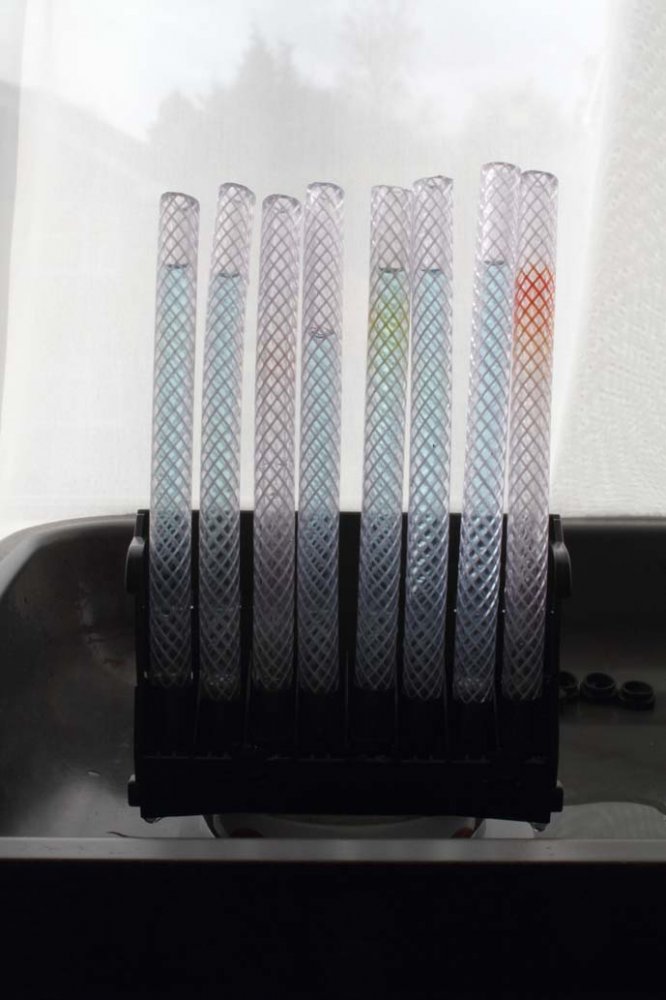

A technique for gently flushing a print head was suggested by someone else in the past (afraid I can't remember who), using 8 pieces of about 150mm (6 inches) of 4.5mm bore plastic tube. If you remove the rubber sealing washers around the input filters, you can push the tube onto each stub. Depending upon the actual tube diameter you may have to wrap PVC electricians tape around the base of the tube to tighten the grip of the seal and ensure it is leak free.
Fill each tube with window cleaner liquid and you can soon see which channels are flowing freely and which are not. Some of the dyes seem to have components which rise to the top.
The pressure is not more than 1/4 psi. If you use significantly higher pressures from a syringe for example, you may displace the (silicone? rubber) seals, between the base of the tube labyrinth and the top of the ceramic? print head plate, leading to cross colour contamination between channels. If this happens the only solution is to take the head apart and reposition the gasket.
As can be seen the PM channel, 3rd from left, is now flowing freely as it had three column flushes before the others.
