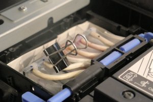

6,364
7,586
You are right, my image of the damper is not the one for the ET-7750, the ink transfer pad is different. We didn't discuss how you replaced the inks yet.
I do it a rather simple way - pulling the old ink through the tube at the side of the damper, the paper clip prevents the new ink once loaded to flow back.
I'm still looking for the service manual, that might give you more information, I got the ET-7750 in Nov 2017 and was trying to find a way to use one of the black channels for a gloss optimizer - which did not work out as intendet but it's all quite some time ago.
I would put the printer back together at this time and see what is still going wrong. It could help to put a piece of kitchen towel paper undertneath the nozzle plat wetted with some cleaner. You may put some cleaner onto the pads in the printhead of those colors which miss some nozzles.
