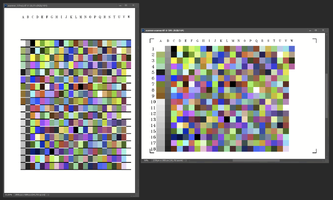

replied to the thread
[Tool] ChromIQ – a macOS and Windows GUI for ArgyllCMS printer profiling (v3.8.0)
OK here it is: I have compress the whole TC9.24 (slightly modified TC9.18 target with 3 extra blacks + 3 extra whites) on a single...
Today at 8:58 AM

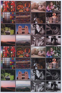

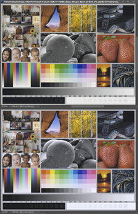

Here is my picture printed with my Epson ET-18100 (CcMmYK: NO grey inks !!!). One printed with the profile made with the latest version...
Yesterday at 10:31 AM

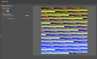

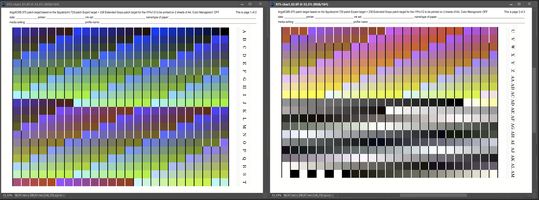

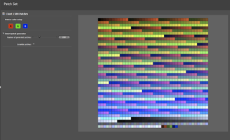

Trying a new custom modified target (TC9.18 + Spyderprint Extended greys target + some extra patches up to 1160 in total to make 2 x 580...
Yesterday at 8:07 AM
