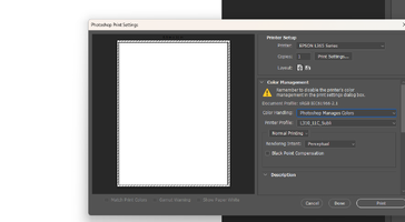

pharmacist Hi Kodak Ultra Photo Gloss, L365 regular, EPSON ink looks fine to me. U can check if im correct from attached files. Thx...

All files. Photoshop also shows no adjustment for white so why it gives me grey hue in white part of the photo?

I suggest to try to make profile on normal paper and compare it to an exisiting profile you use for that paper type and see if your...

Found out what the problem. Printing and scanning just before that. Printed old 228 patch scrambled… After that printed newest yours 266...

Something is messed up. I don't know what your .colors file is. I generated an A5 10mm patch target from your 228 ti1 file with this...

Im using photoshop to print and the target was printed using ACPU. Printer works just like normal one its EPSON L310. Weard about white...

Are you printing with a RIP or a standard printer driver: note the target is for RGB printer drivers and RIP programs need CMYK targets...
