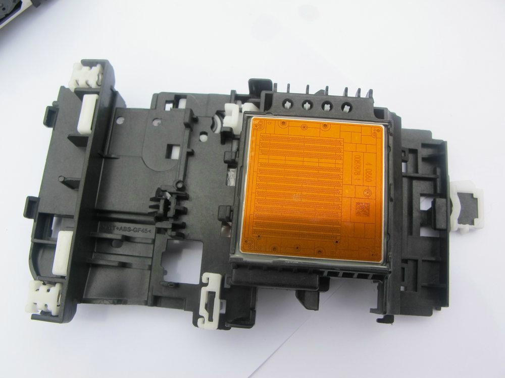

The DCP-195C can use high capacity BK:100ML, C/M/Y: 70ML carts from china.
I don't know about chips as my Brother has none too. I see ARC carts or seen resetters for brother carts. The octopus office has even some overprices original brother fill adapters that can be bought from aliexpress for few $
Wither way the printheads on Brother are piezo as EPSON but are superior in how they are made.
Brother printhead below:
Smile
Aug 23, 2006
1,984
449
Europe EU
If only brother would make 6color printers, but the small 2pl droplets compensate for steps seen on printers with 4 colors compared to 6 color printer. Drops are placed very uniformly spaced not like Canon, HP who "splatter the ink all over the place".
