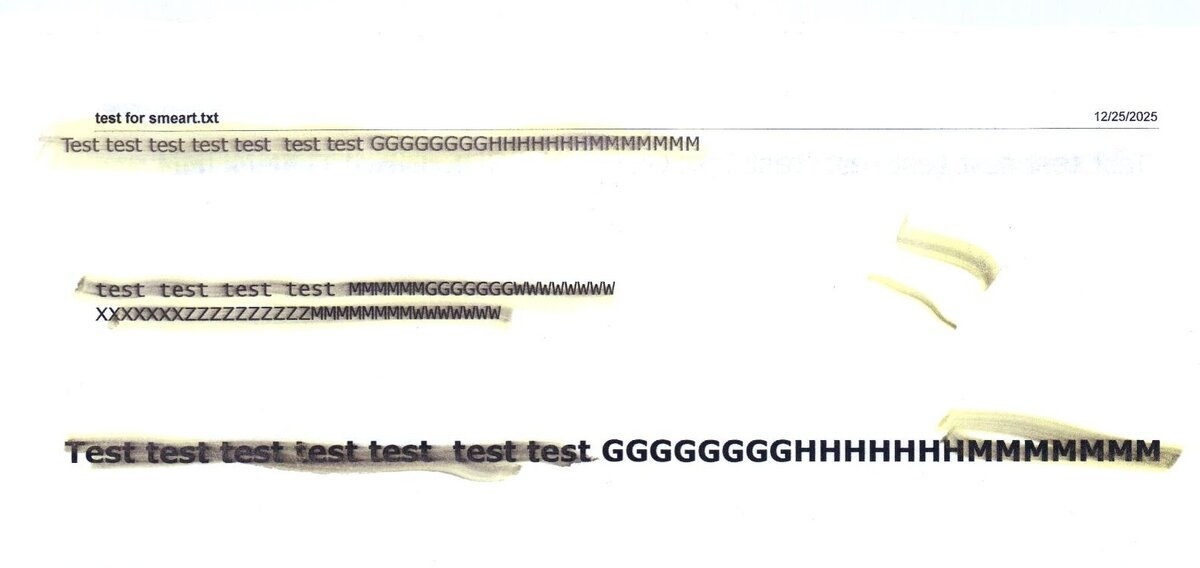

I just tried a number of random test using a 1 or 2 line series of letters.
I also checked "Grayscale" printing (which I doubt I ever used that) and the guaranteed 'smear' result was that which was expected.
Again I used Open Office and Notepad2 typing up a row of random letters (I didn't need a full page of text).
Mine you there is some 'smear' (1st line) normally, but not the 'wash' I sometimes get of very recent (last line)
16,163
9,115
Greyscale can cause the printer to use both inks instead of just one, Just like when using duplex...
