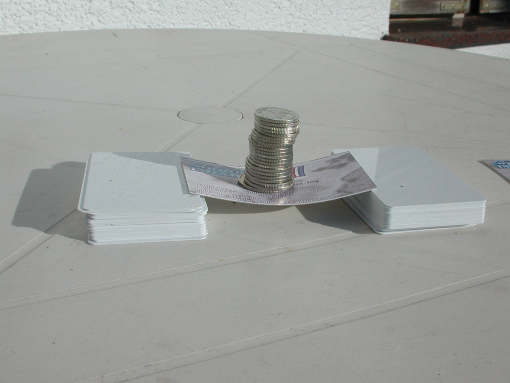

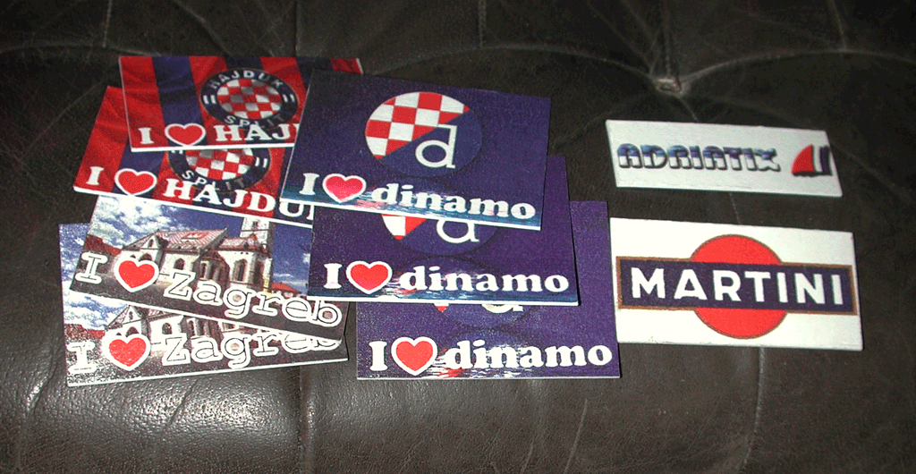

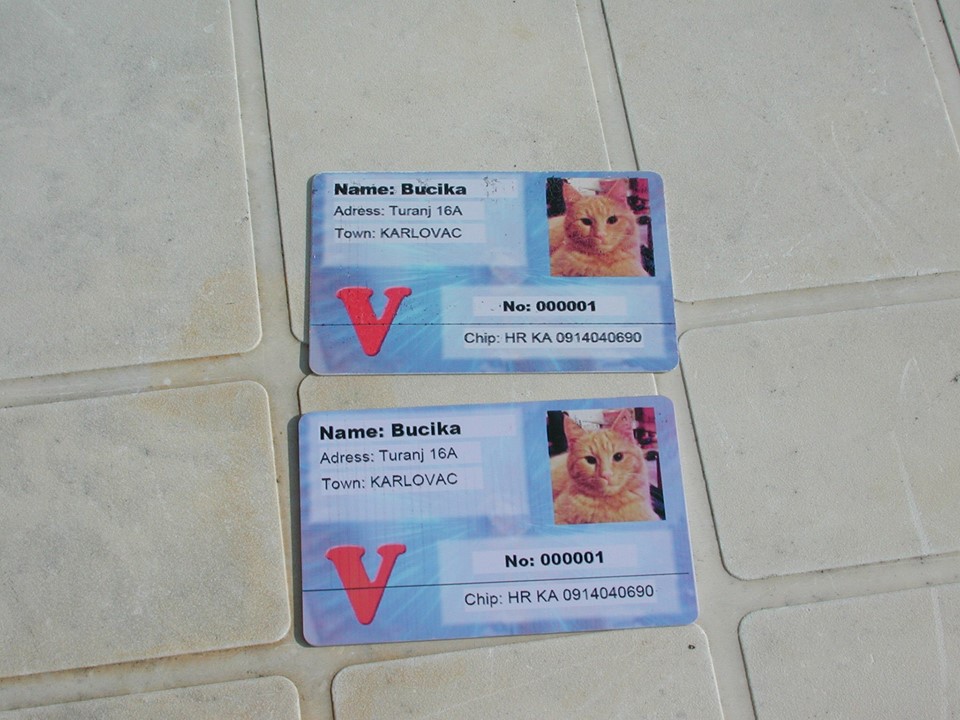

Take a look at below image. Visit card vs Credit CR 80 card
This is stacking process. You print your first visit card image on any printer you like. Then you take an HP LaserJet 1200 and print on 200 gr m2 an mash Then you stack photo print + 200 gr m2 + 200 gr m2 and use some laminator to merge this sandwich
And that is easy 300 400 or 500 gr m2 visit card
But if you like to print directly to 400 grm3 visit card then you can take that paper cut it in particular visit card. Glue it by double face tape on same piece of paper an d put in an Canon iP 1800. And prin to it. Here is an sample printed directly on Canon iP 1800 at printable CR80 credit card
Or you can try sublimation transfer on any type of paper weight
