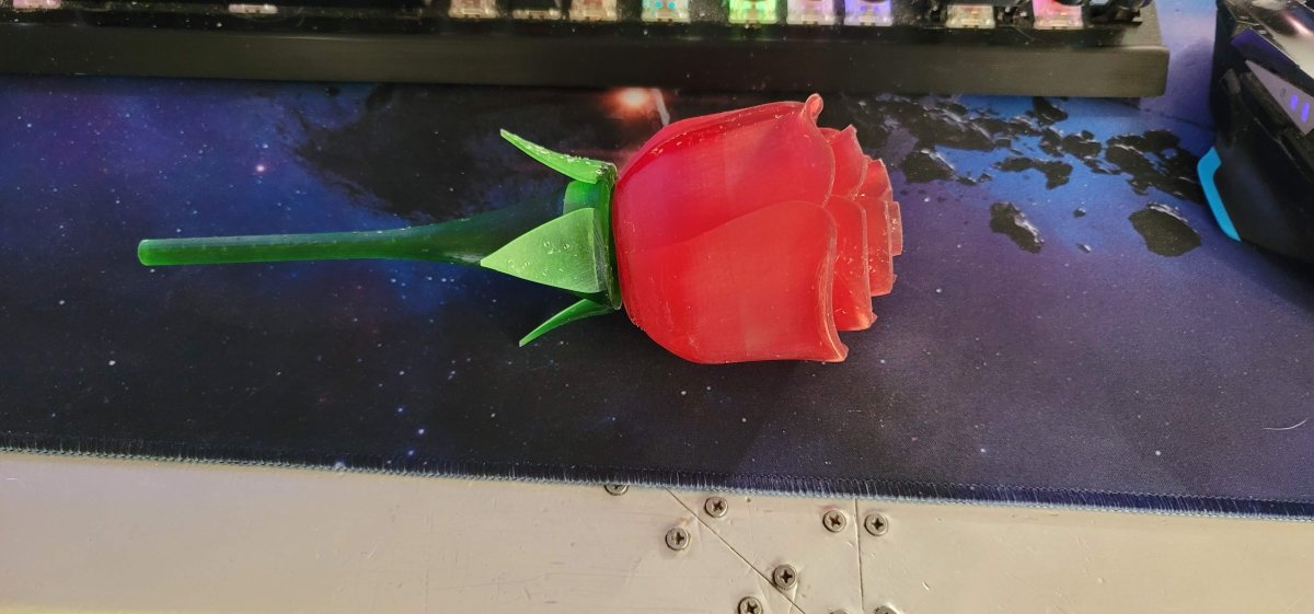

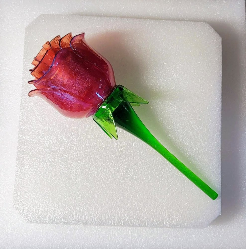

Christmas prezzie for the Mrs. She loves roses but they always die. So I made her one that won't.
Roughs after printing using elegoo transparents.
Finished. Lots of hand wet/dry sanding to 3000 grit, then a clear resin topcoat to restore the transparency. The petals also had a bit of shimmer mica flake in the topcoat to get a little sheen. After full cure, some rattle can clear enamel.

That's crazy amazing!!!!!
Excellent work!
Did you create the STL or grab it from somewhere?
Your final result SUPER reminds me of when I used to do really basic "glass blowing" (which was me using pliers to squeeze glass I melted with propane torch) ;)
