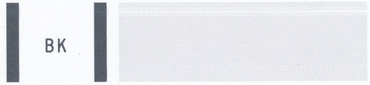

Please see attached 2 files (hopefully that works ok). The first one is the original nozzle check done a week or two ago, the second is the one from today, #19, and I have 17 more nozzle checks in between these two. I'm refilling OEM carts with PC inks. This is the first problem ever with this printer. What I've tried so far: Cleanings, no more than 3 or 4 in a row. Deep cleaning, just one. A couple of Qimage's unclog pattern. It appears to me the only thing that has changed after all this is it looks a little worse now than it did to begin with. Maybe I should have just ignored it and it would have cleared up on it's own.....? Zooming in on the white band in the BK shows a weird pattern, I've never seen something like that before.

It’s quite possible the print head is failing on some of the BK nozzles, and you can’t do any more than you’ve done already to fix the issue, but rather than carry on and ignore it, I’d recommend you use OEM BK ink, purchase one new if you don’t still have an old one.
If the head has bits of old ink lodged in the nozzles the OEM ink is just about the only thing that can remove it safely, so just print as normal with the BK OEM ink and hope for the best, in the mean time I’d purchase a new head anyway..

I can't really see that weird pattern in the white band in the BK in these photos. Can you guys see them ok? Well, anyhow, I'll post a close-up of it here, just in case it helps to figure out whether this is printhead failure or clog or whatever.
Is the OEM ink like a cleaner or something? What's the difference? So.....is it more likely a print head failure, as opposed to a clog? Is air in there a possibility at all?
Yes the OEM ink can clear old ink out of the nozzles, (it’s a far superior ink) your issue maybe a few clogged nozzles or it may not, and if it doesn’t clear then those nozzle will be lost for good, and no, air is only an issue with Epson print heads..

I can't really see that weird pattern in the white band in the BK in these photos. Can you guys see them ok? Well, anyhow, I'll post a close-up of it here, just in case it helps to figure out whether this is printhead failure or clog or whatever.View attachment 13289
This is the kind of pattern I sometimes see on my pigment printers (with MBK I seldom use) and it normally disappears with some patience.
Wait until next day and print a few nozzles checks again.
Eventually one normal cleaning cycle.
As said changing inks can help too.
