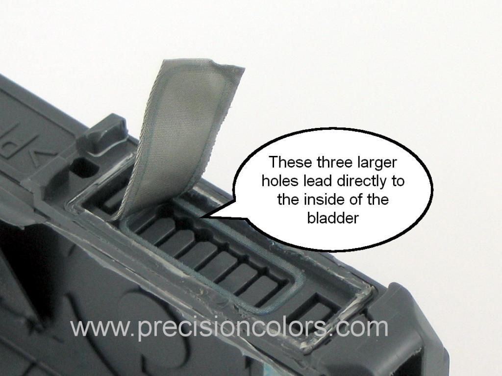

Not had the time to delve into this myself but glad I read through this thread and caught up today.
Fascinating images and design that certainly show a well engineered solution from Canon and make you wonder just how well, if at all, the third party sponge alternatives work. Frankly, I shudder just thinking about it.
Not entirely sure I agree with the third hole acting as a vent hole for the filling process as noted in the flushing thread, the air would need to be in exactly the right place for it to exit but in truth the filling process will be a mystery unless someone goes all Mission Impossible at some point :). Either way it's a moot point.
The only thing I'd add is how the bellows compress when air/ink has been evacuated to show how the design effectively blocks off the fill holes. I'm prepared to be proven wrong but I still suspect there's an element of design here that is less reliant on the sponge moisture content than has been postulated. I don't have the engineering vocabulary to explain it but take a look at this image:
http://i2.photobucket.com/albums/y20/mikord/IMG_2697.jpg
... and note the "shelter" style design around those outlet holes.
If you look at the way the bag collapses onto this shelter it seems to form a sort of closed gate using the "shelter" as a analogue of the gate posts/frame. When you couple this with the way the bag folds inwards to rest against the inside walls, thus creating a resistance against the spring and re-inflation as well it looks as if the design was deliberately intended to stop an empty cartridge appearing full.
Stepping back from the mechanics a second, there's a good reason for wanting to do this (and not because it hands refillers a golden ticket of non-air ingestion). A cartridge that re-inflates/expands would potentially fool a user into thinking the cartridges was still full/useable so retaining the plate in the "empty" (far-wall) position acts as a visual indicator of being empty for the user. Granted you have the chip but as with the chipped sponge carts (eg: CLI-526's) you still have the prism backing up the chip so redundancy appears to be courted in Canon designs.
As I said, willing to be proven wrong but it does seem more than a little odd to have that shelter design over the outlet holes otherwise.
