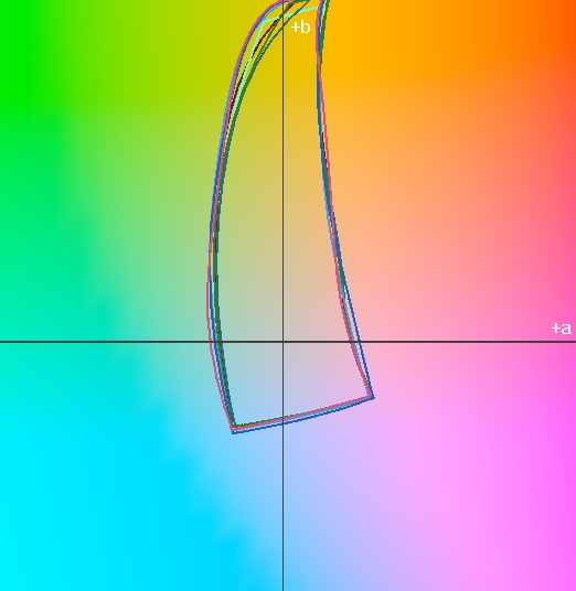

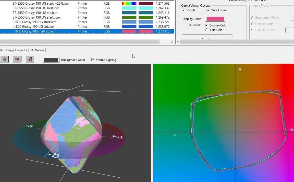

I ran some profiles on the ET-8550 and the L1800 to compare them , I'm using a 190gr PE/RC paper - no brand - and I'm using the paper selection 'Ultra Glossy' and the quality settings normal/standard and high/stark, the ET-8550 offers another quality level 'best', and there is one profile with the matte paper selection. The ET-8550 offers an additional option to modify the ink density from +20% to -50%, - somewhere hidden in the extended settings. The graphs below are an overlay of seven of these profiles showing the gamut volumes, they are almost identical and the actual profiles as well at different lightness levels. They vary by not much more than reading variations by the spectro.

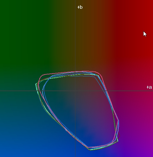

The right plot shows the cross-section at the mid-luminance of L*=50, this following graph shows the cross-section at a lower luminance of L*=25, they are still pretty much similar

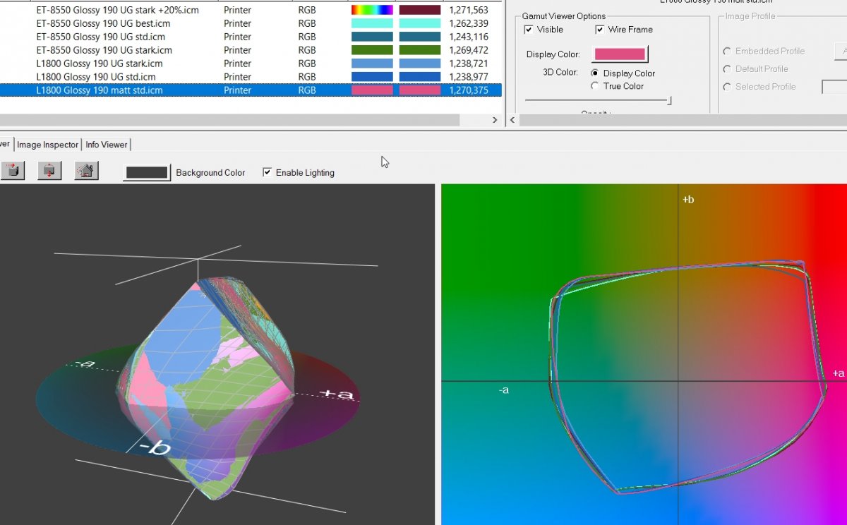

And this plot shows the profiles at a lighter luminance of L*=80, still pretty much similar.
The L1800 runs with light inks - LM and LC - the ET-8550 does not, but the above profile displays show that this does not make a difference at all - there is no gain at all in the lower quadrants - in direction of magenta or cyan. The ET-8550 and L1800 very much deliver the same color output - gamuts as shown here.
