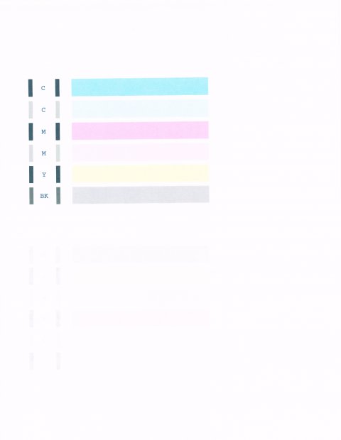

I have been drizzling either 91% Isopropyl, or more recently a Windex/91% Isopropyl mix onto the left pad for 10 days now.
Here is a scan of no (pigment) black nozzle check:
You will see a faint image of another nozzle check - that is the reverse side of the paper. I am trying to reduce the amount I am using with this effort...

pourhaus,... All of the suggestion were a good first attempt at correcting your purge problem,.. but since they did not work the problem is deeper inside the purge unit. I have helped many people fix this same problem and in fact I have an MP530 on my bench right now with the same problem. No amount of cleaning fixed it so I ordered a new purge unit from Canon and I'll put it in right away.
The problem is you have to competely disassemble the MP830 down to removing the main printer assembly from the base,... and then you still have a lot of work to do to remove the purge unit. Once you get it out the problem could be several things and some you may be able to fix. The simplist is that the black suction tube from the purge pump has come off. If the tube is off, it can never suck any ink out of the ink carts--down through the printhead to prime the head and therefore it will never EVER print any black. Another possible problem is the black tube inside the pump is out of position and therefore no vacuum and no suction. I could go on and on with problems but it all comes down to taking it apart. To get more information on how to take it apart you need one of my Repair Manuals. Send me an email and I'll tell you how to get one.
Before you do anything you need to do one more test to confirm the purge unit is bad. Since you have done all of the cleaning mentioned on all the previous notes, the large black pad where the printhead parks must be rather clean, almost white. If you didn't get it clean with all that you have done, then just add some warm water and use folded paper towels to blot the pad, over and over until you do get it almost white. Now use your control panel>printers/faxes>select MP830>preference>maintenience tab> and do a cleaning cycle on black only (or just cleaning if you don't have that option). Now open the top cover and use a flashlight to check the large pad. If there is no wet black ink on that pad, your purge unit is broken.

pourhaus
Aug 5, 2009
Have to tip my hat to Trigger 37 - the procedure identified the problem, but possibly only because I added an extra step.
Here is a wide shot of the printer with the front tray open, lid and platen up, focusing on the purge pads:
I decided to test if the left (PGBK) purge was working using Trigger's method - clean the pad, then run a head clean to see if we get ink on the pad.
Here is the before shot of the pad - pretty clean:
Here is the after shot:
Seeing that I did have ink on the left pad, I thought - has something changed, let's run a nozzle check and see:
YES!!! Finally.
My tip - when you take the pad off to clean it (which is very tricky BTW), dab some paper towel or q-tips around in the now exposed purge tray to soak up any ink (hopefully dissolved by your cleaning efforts). I did this three times. I must have unblocked the valve or other area leading down to the purge pump.
I would add that yes, I did not see my cleaning fluid drain down all that fast during my efforts over the last two weeks.
I will now be dripping some cleaning fluid onto that left pad on a regular basis.
Thanks to all who offered advice on this.
