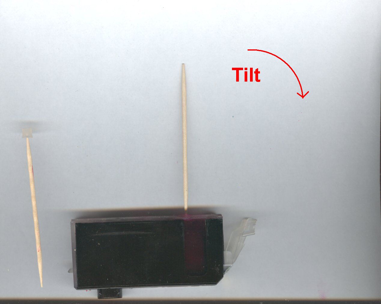

Zero clearance plugs plus aluminium tape is also what I use and recommend for the PGI-x20/Cli-x21 and PGI-x25/CLI-x26 cartridges. I also use and recommend top filling for these cartridges, as I suspect the sponges in these cartridges to be more fragile and more easily damaged by a needle than the sponges in the older transparent cartridges, for which the German method works very well.
A wooden toothpick/cocktail stick is a handy tool for inserting and removing the zero clearance plugs, as they have a small centre hole. Take care not to pierce the plug. Here is the "tool":

Hey thats a very good picture of how to do it. I forgot, I just bought some of those plugs and they are sitting on my desk right now. duh forget a lot of things these days. Actuallly I bought them because I wanted to see them and thought maybe I might try top filling a set of carts.
