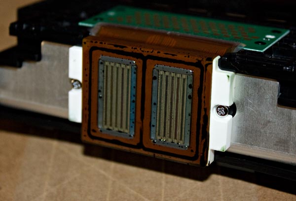

It doesn't look good guys. After washing the head out thoroughly then soaking in windex, I put it in the vicinity of a furnace vent and gave it about 24 hours to dry. When I put it all back together I gave it two regular cleanings and it couldn't even print a head alignment; it got one partial line printed and quit. Then I gave it a deep cleaning and a regular cleaning and tried again and it was the same. A nozzle check was a horrible mess. When I took the head back out there was green ink all over the bottom of the head around the nozzles. I cleaned it up and put it back together and tried again. It got a little more of that one line printed of a head alignment and quit again. Took it apart again and there was the green ink again. Looks like I broke it somehow even though it looks good.
Oh, and the ink is definitely coming out during those cleanings; I started this with almost full carts and the ink levels are all way down.

After many cleaning cycles, I was able to print a nozzle check, which was good except for two colors, PC and PM. While the other colors improved and finally lost their white lines over the course of many cleanings, these two haven't changed. So I went back to the windex followed by hot water and the nozzle check is exactly the same. I have at least 12 that look exactly like this:
And I would continue cleaning, except that the bottom of the printhead looks like this:
I confess I never looked at the bottom of the printhead when it was working right, but I believe the heavy lines and globs of ink aren't supposed to be there. I clean them off and they just keep coming back. So I think I see a new 9500 in my future. (I thought I'd give that a try since they're so cheap right now.)
