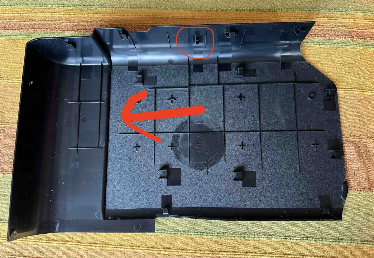

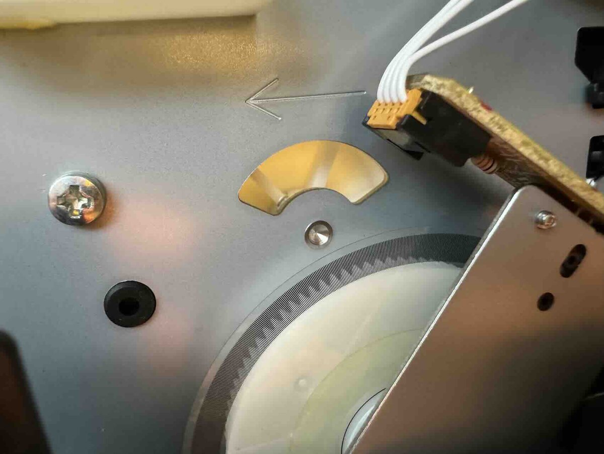

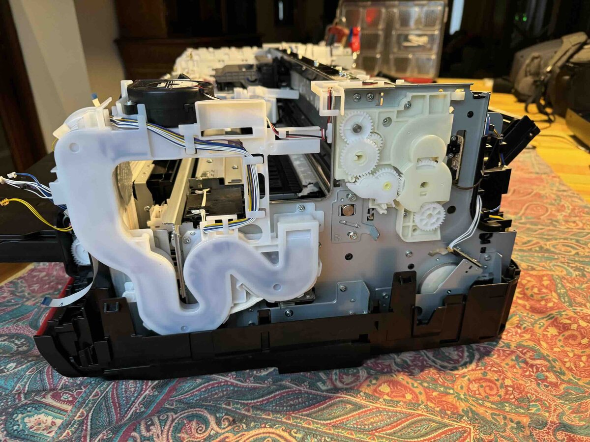

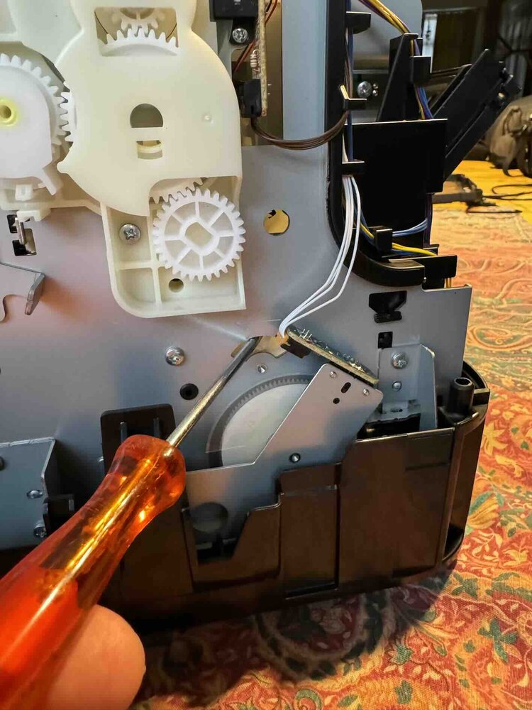

Hello,
I have a Pro 1000 with te same Error B204 and the printhead is blocked.
I found to solution to unlock printhead.
at the right side there is a gear to unlock the printhead.
I have removed al the covers, but it isn't necessary,
you need only to remove the right side cover and you can acces to the gear
turn the gear counterclockwise by a screwdriver and it will unlock the printerhead,
you can move it

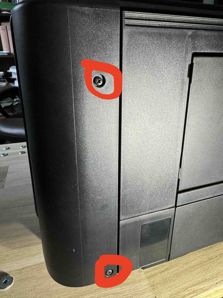

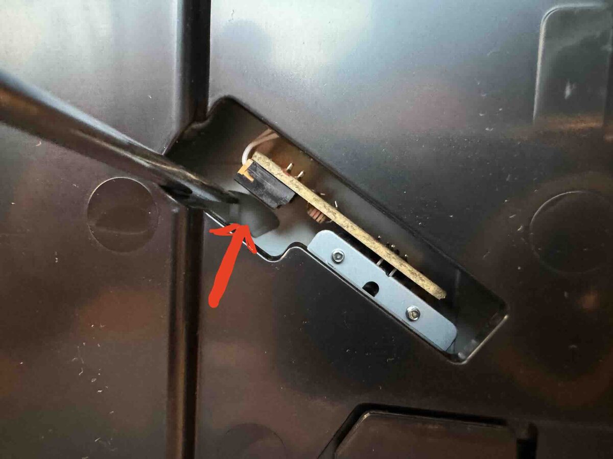

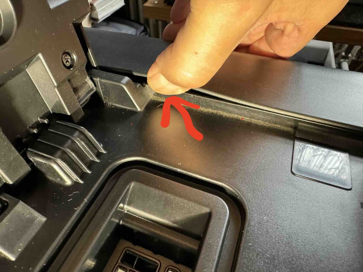

Here how you can open the right side panel
remove 2 screws at the rear of the right panel

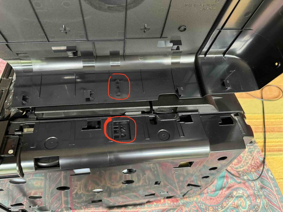

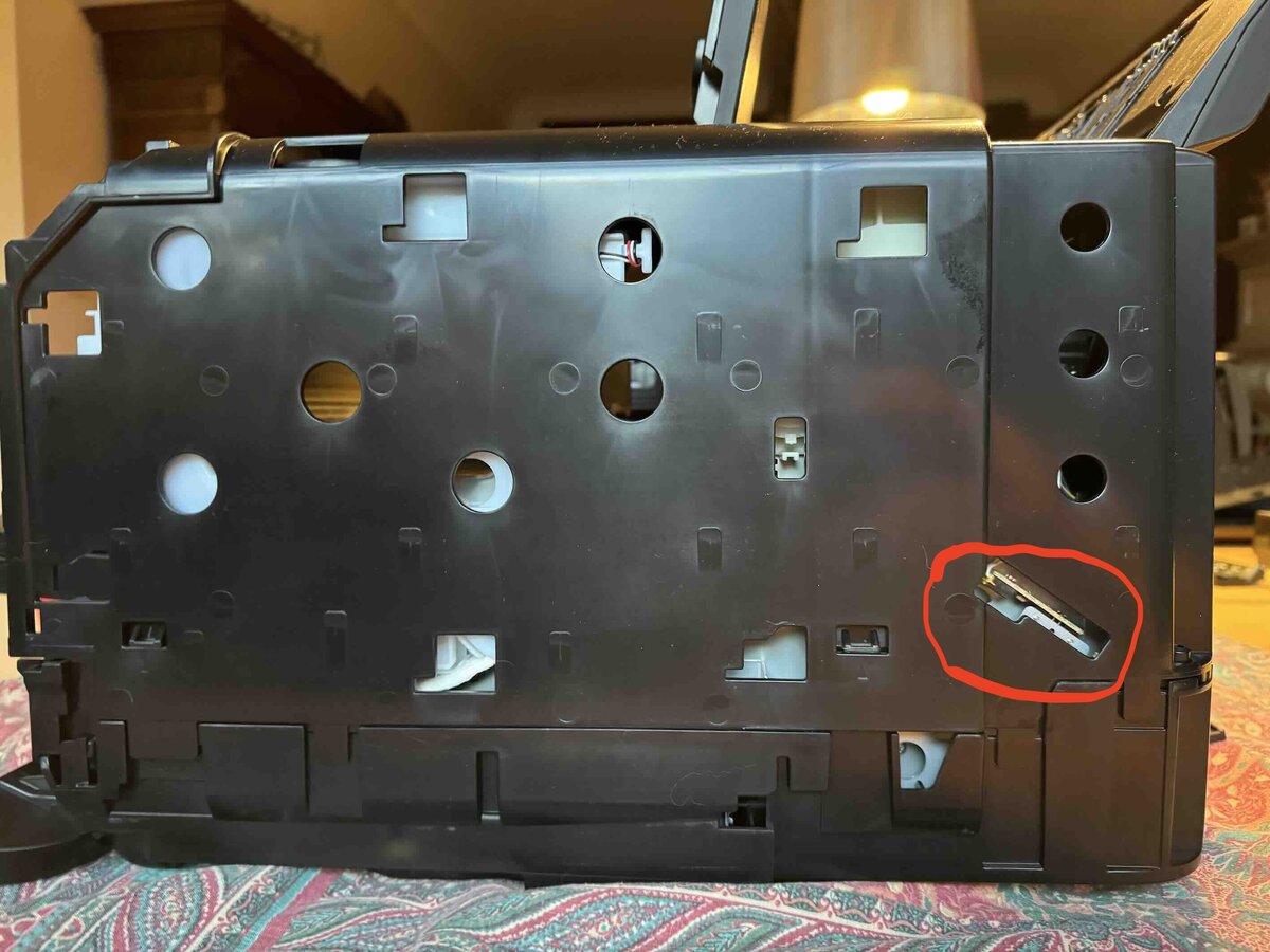

than lift up the cover here, and slide de cover backward ( it isn't easy )
here you can see the tabs fixing the right cover on the printer

Hello,
you can move it
View attachment 16449View attachment 16450View attachment 16451View attachment 16452View attachment 16453
View attachment 16456View attachment 16457
