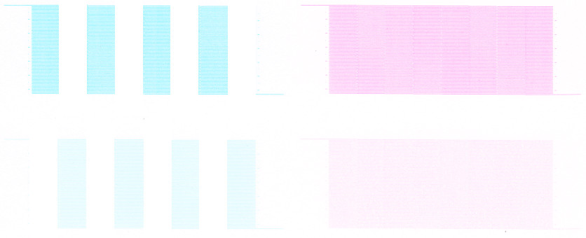

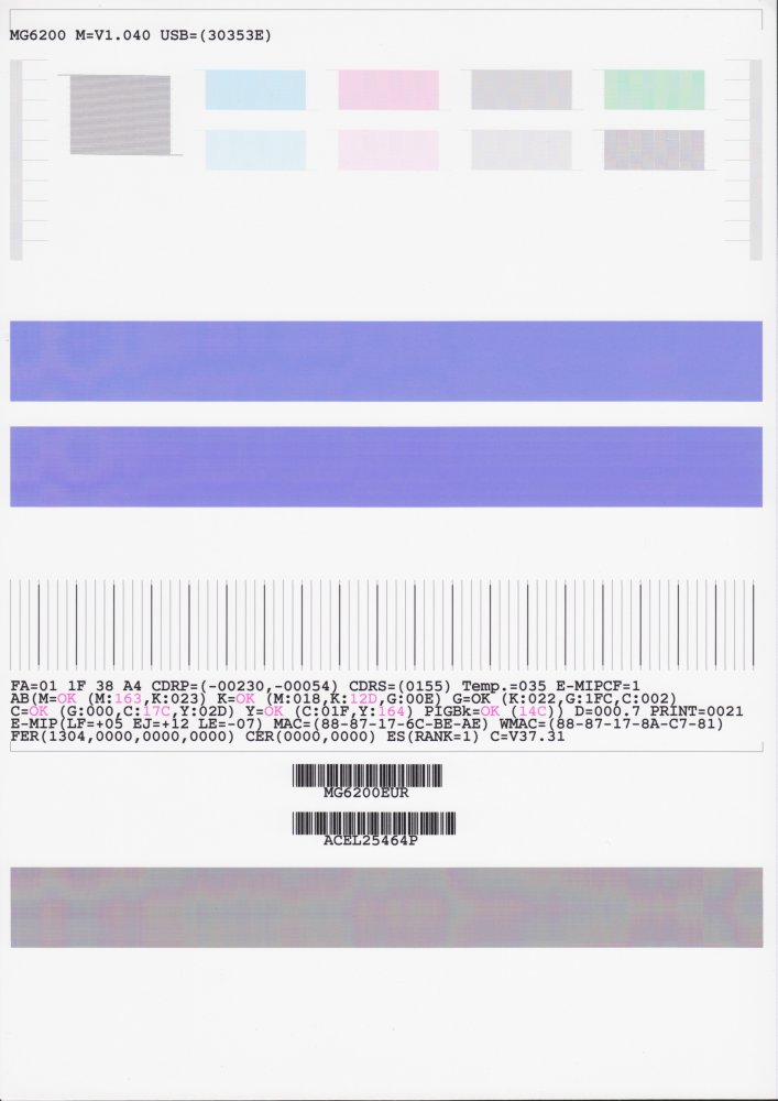

Hi,
it is also good to print test print from service mode - in most Pixmas it has grid-like nozzle check. Some inks are dual-channel, and if one "ink channel" fails to deliver ink, user mode nozzle check strip is lighter. But test print nozzle check will lose odd or even column of its grid pattern when one "ink channel" fails to deliver ink.
One clogged "ink channel" on Cyan should look similar:
Please note that missing pattern on 5 pl is "inverted" to 2/1 pl pattern.
But if for example 5 pl pattern is continuous and 2/1 pl pattern is dashed (or vice versa), electrical damage is likely rather than clog.
Also looking through a complementary coloured filter will enable the viewed colour to appear darker. IE: A blue purple filter to look at the yellow nozzle check.
Well, same thing may be done with scanned image in almost any (freeware) picture browser (IrfanView, FastStone etc) by extracting one of RGB channel (for yellow ink it is Blue channel). Then yellow is displayed in grayscale - max yellow is then black.
In addition have some cheap coated photo paper to run nozzle checks which also helps give a visually more dense view of the nozzle check colours.
But, if better photo paper is used, nozzle check would appear to be lighter. But (again but), it is better suited to expose faulty nozzles (most likely distorted by overheat or just clogged).
User mode nozzle print and it service mode counterpart printed on low weight super glossy photo paper (1200 dpi scan converted to grayscale):
Please note distorted nozzles phenomena:
- partially blured user mode nozzle print (1/4 from top and 1/8 from bottom end)
- vertical white and dark "strips" between columns of odd and even nozzles in grid-like service mode nozzle print
Thank you for explanation of the "extended nozzle check"
This exactly happened to me: user nozzle check showed light magenta or cyan "too light" and the following extended check showed the damage.
