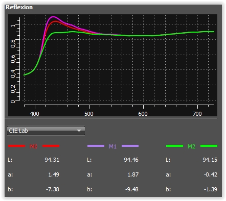

...The OBA's transform some of the UV - non visible - light into a blueish/violet light via the fluorescence effect . You effectively would need different color profiles for all these different conditions. But the eyes can make quite big compromises in this respect so as long as you are not in the commercial printing business you can run some tests for yourself when you create profiles on your own - like D50 or D65 as the typical settings and different measuring settings like M1 or M2 - with or w/o inclusion of the OBA effect.
Let me show you the differences, this is the spectrum of the white point of a typical glossy photo paper, with lots of OBA's

so I thought all the UV would be absorbed.
Most of it - it always depends , you would need to get the spectral transmission curves from the glass manufacturer. Sure you can measure the spectral distribution of UV light , and just remember the issues with UV radiation around health subjects - the risks of UV A or B or C, long term exposure, cumulating effects and all that, UV radiation in this general term has a much wider spectrum spread than visible light, everything from about 350nm to a few nm is considered UV , just look to the latest generation of chips with 7nm structure width, it is done with eUV - extreme UV. And yes, there are flourescent colors, inks, as well available for inkjet printers. You would need to get the data sheet to see at which wavelengths they become active, 'black light' is low frequency UV just above visible light, the visible light is filtered with a coating in the black light tubes.
