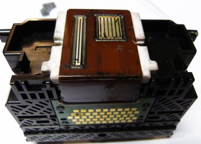

So after getting a new print head for the iX7000, I decided to pull the old one apart to see how bad it was clogged up
and maybe learn something from my expensive blunder. (I decided to take some Photo)

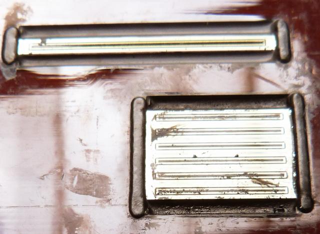

This first shot shows that the print head has six small nozzles and one large one.
On a close up of the nozzles it can be clearly seen that some of them are completely blocked
up with congealed optimiser which was going nowhere fast.

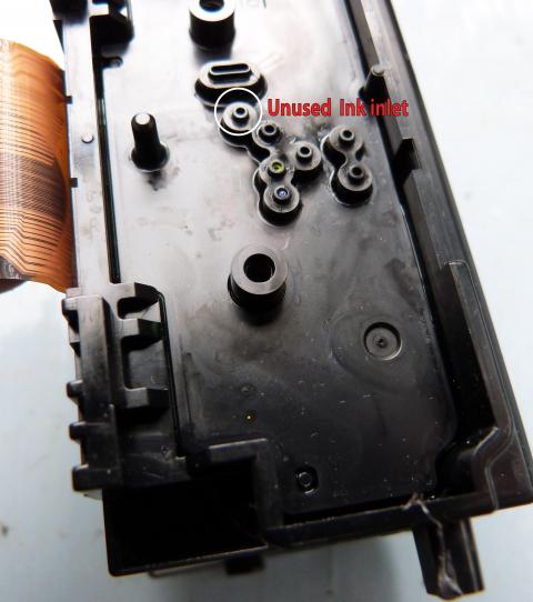

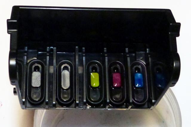

Here it is clear which inlets are blocked and are not allowing the ink to enter the print head.

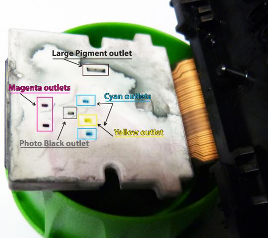

In this shot of the inside there are eight outlets which allow the ink to flow from the cartridges on its way to the nozzles,
but only seven are use on this printer.
I coloured marked the inlet holes on the ceramic plate to make it easier to identify which is which,
there are two Magenta and two Cyan channels and one each for the PK black, yellow and the PG black.

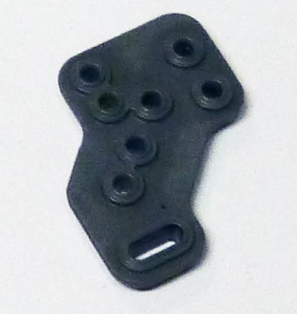

Here is the plastic diaphragm (Washer) that makes the two pieces fit snugly together to give a perfect seal between the two pieces.

After I soaked it for a week in various substances that I had found under the kitchen sink,
I reassembled it and done a test nozzle print, I managed to get about 50% of the magenta,
cyan and yellow back working again; the other two blacks were at 90%.

Hmm normal ink ports like on Pro 9000 are round so you can use a tube, but with ellipse ink inlets how do you purge the head? Silicone flexible tubing?
