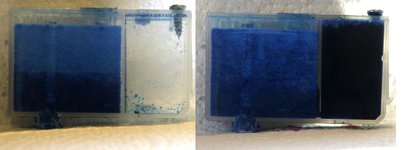

This is an update on the "don't touch the carts" test. When the carts were first installed, several cleaning and 1 deep cleaning cycle were required to get a perfect nozzle test pattern. There were a lot of cart changes before the start of this test, and it took a while to get everything back to perfect condition.
A total of (35) 8.5x11 sheets of photos were printed when the low ink level warning came on for both the PM and PC at the same time. During the printing of these 35 sheets, there were two instances where the magenta was missing on a nozzle check (all other colors were perfect and there was no magenta at all) - a single cleaning cycle fixed the problem in both cases. Otherwise, there were no problems while printing the 35 pages. Note that the power to the printer was never turned off during this time to prevent any extra head cleaning cycles. If the printer had been set to go into standby when it was idle and did an automatic cleaning cycle every time that it was reactivated, no additional cleaning cycles should have been necessary.
The total of 35 sheets before emptying a cart was at least 15 sheets less than expected. It is assumed that the main reason for this was the extra cleaning and 1 deep cleaning cycles performed after the carts were first installed.
After the low ink warning, all 8 carts were pulled to inspect the ink levels. Only the M, C, PM and PC were replaced, as the other 4 carts were still more than 1/2 full. Actually, the magenta was also more than 1/2 full, but I wanted to see if there was a reason why it lost its feed twice. A single cleaning cycle was run and a nozzle check pattern printed. There was ink in all of the colors, but not always the correct color (as has been reported by others). A single heavy color pattern was printed to clean the ink channels, and everything was back to normal. It is interesting that pulling the carts when everything was working perfectly just a few minutes earlier and replacing them with either the same or full carts within 60 seconds of the first cart being pulled was still long enough to cross-contaminate the colors.
These two images show the PC and PM carts before and after using the "Pressure Refill" technique to force ink back into the sponge chamber. The (natural) lighting changed slightly between the shots, so the appearance of the bottom sponge may be slightly different - it was actually the same.
It can be seen that the bottom sponge is still almost completely full (there is a little air in the top corner of the sponge next to the ink chamber). The appearance of the top sponge was similar to the bottom sponge when the carts were first vacuum refilled, so it appears that the upper sponge has been at least partially drained. From the appearance of the partially used carts, it can be seen that ink from the upper sponge is used before the ink chamber starts to drain.
The "Pressure Refill" technique was easy to use and allowed about 9 CCs of ink to be injected instead of the normal 6CCs required to fill just the ink chamber.
The only thing that was strange about the magenta cart is that it took more pressure to blow ink out of the exit than the other carts. Two drops of isopropyl rubbing alcohol were dropped onto the exit filter, left sit for 1 minute and the pressure test repeated. It did seem to take less pressure, but this could be because we often see what we expect to happen, the alcohol could have diluted the first ink to come out and the pressure will increase over time, or the alcohol could have broken down an old ink residue.
Based on this single "don't touch the carts" test and the success of refilling using the "pressure refill" technique, I plan to continue waiting for the "low ink" alarm before pulling the carts. The "vacuum refill" technique will be used when the bottom sponge looks like it is getting too much air or if the cart doesn't feed properly. If periodic extra cleaning cycles continue to be required, the printer will be set to go into "standby" mode when it is not in use so that it will do a cleaning cycle when it is reactivated.

Grandad, I noticed in your images that your ink level in the reservoir is pretty high, especially in your cyan cartridge. Have you had any "overfilling" problems when putting this much ink in?
Also, you pull the carts when you get the warning. Is this the warning from the prism or from the internal droplet counter?

I haven't had any problems with "overfilling" the ink chamber. The new carts that I have looked at are also filled to the top. Using the "vacuum refill" or "pressure refill" techniques, it is possible to overfill the sponge chamber so that the ink is above the top of the sponge. This will cause the cart to drip until the ink is either absorbed into the sponge or drips out until the ink is all contained in the sponge(s).
The low ink warning was from the prism. As the photos show, it did a great job (at least in this case) of indicating that the ink chamber was completely empty, but that the bottom sponge was still full of ink. I looked at the "predicted ink level" display just a few sheets before the "empty" warning appeared, and it showed the same "30% full" level that it had shown since the new carts were installed (the carts that were replaced at the start of the test weren't empty, so the counters weren't reset at that time).
